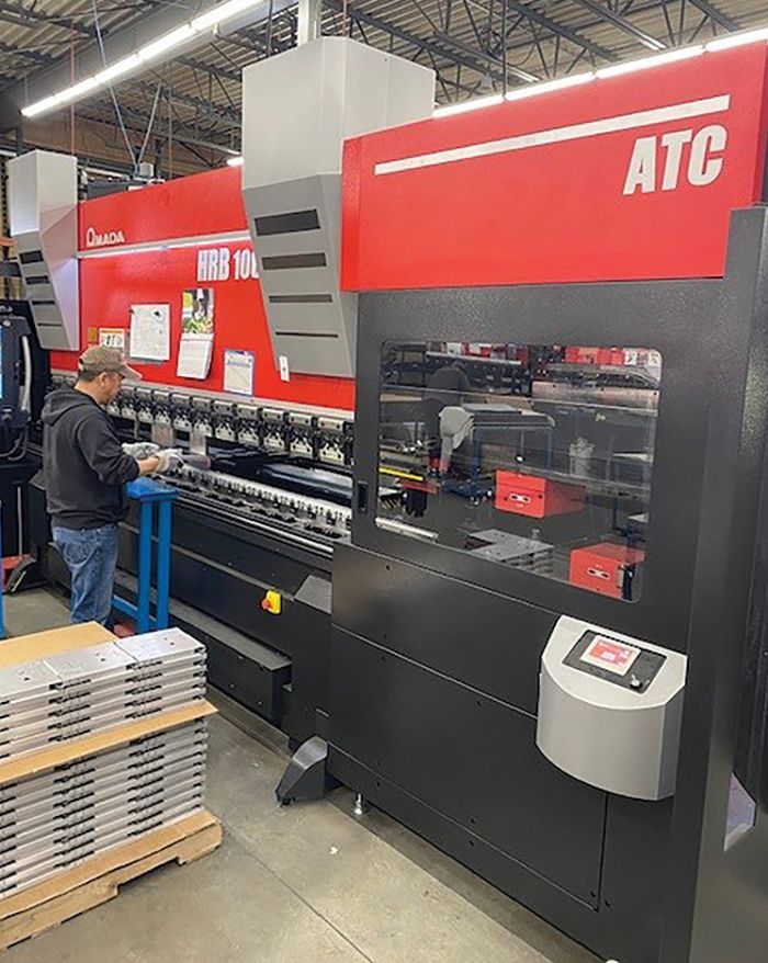

To address its setup-time challenge, as well as down-skill press brake setup and operation, Diamond Metal Products recently replaced a 15-yr.-old press brake with a state-of-the-art Amada HRB 1003 model, equipped with Amada’s automatic tool changing (ATC) system. The ATC enables job change-overs in as little as 2 to 3 min.
“We can run 10 times the number of jobs on this new press brake per shift compared to our other machines,” Pahl says, noting that management schedules only shorter-run production jobs of five to 50 parts on the new brake, and programs it offline so as to not interrupt production for programming.

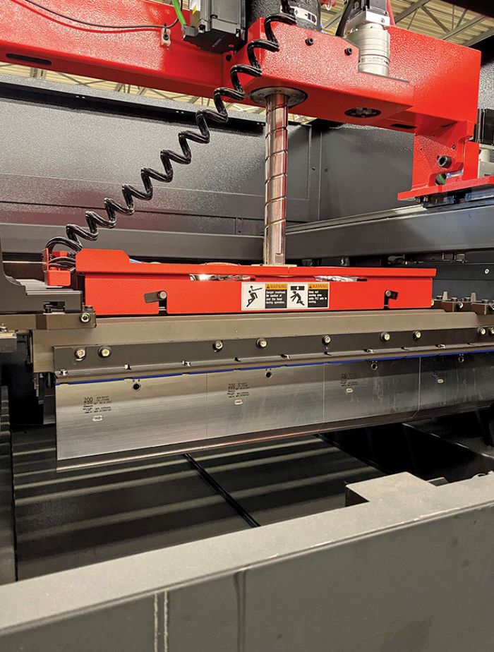

The ATC features multi-axis manipulators that pick and place punches and dies from the machine’s tool magazine based on the part-bending program uploaded into the machine control from the engineering office. As the machine requires custom tooling to enable automatic tool changes, Diamond Metal Products ordered all new tooling for the HRB 1003 ATC, “after Amada came in and looked at the types of jobs we’d be running through it. Right now, about 90 percent of what we fabricate can run on that machine as currently outfitted with tooling, and we still have some allowance remaining to add more tooling. The ATC is about 75-percent full. But being at 90 percent is huge for us, even if we don’t yet run that much work through the press brake.”
One additional benefit of the ATC touted by Pahl: setup repeatability. Operators manually loading tooling may not place the tooling in exactly the same place along the machine bed from one setup to the next, Pahl says. “That affects part-dimension repeatability,” he explains. “Now when we program a job, we know with certainty that the ATC will load and position the tooling repeatedly in the brake time after time.
