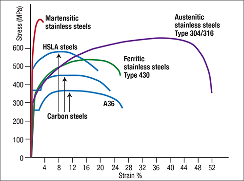

Stamping companies and tool shops experienced with plain carbon steels often have problems making parts from stainless steel. Negative past experiences and poorly designed processes often produce poor results that can fuel misconceptions and myths regarding these corrosion-resistant materials. For example, most stainless steels have work-hardening rates that are greater than those for plain carbon steels. A common misconception is that stainless steels are less formable than low-carbon steels because they work-harden too much. In reality, stainless steels are very formable—many grades have substantially higher ductility than plain carbon steels. Stainless steels frequently are deep-drawn into very complex shapes without the need for intermediate annealing. Even the less formable ferritic grades have outstanding ductility (Fig. 1).
However, due to their high work-hardening rate, more press power and press energy is required to form stainless steel. Frequently, a 100-percent increase compared to low-carbon steel of the same thickness is required.
A unique feature when cold-forming stainless steels is that more severe deformation is possible when slower forming speeds are used. This is different from plain carbon steels that form virtually the same regardless of the forming speed. In general, when forming stainless steel into difficult shapes, you will want to slow down.
The required clearances between the draw post (punch) and die-cavity wall will be greater for stainless steels compared to plain carbon steels. Austenitic grades require sheet thickness plus an additional 35 to 40 percent; most ferritic alloys require sheet thickness plus 10 to 15 percent additional clearance.
