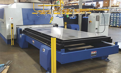

A 3-kW fiber-laser cutting machine has allowed Weber Specialties to serve low-volume customers while gaining flexibility to produce prototypes and adapt quickly to changes in part designs, all while cutting lead time in part production. |

The new laser-cutting machine easily handles Weber Specialties’ typical part stock, including low-carbon, coated and stainless steel; advanced high-strength steel; aluminum; brass; and nickel; in thicknesses from 0.010 to 0.5 in. |

After a four-month search, in February 2016 Weber Specialties brought a new fiber-laser cutting machine to the shop floor, a FS 3015 model from HK Laser & Systems USA, Lombard, IL. (Weber Specialties ultimately added a CO2 machine, dedicated to cutting Mylar for a specific project.)
An upgrade to 3-kW power enables the FS 3015 to easily handle the company’s typical part stock, including low-carbon, coated and stainless steel, advanced high-strength steel, aluminum, brass, and nickel, in thicknesses from 0.010 to 0.5 in.

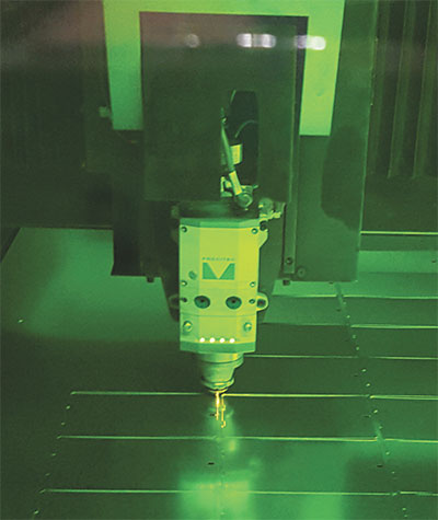

The machine features a durable rack-and-pinion motion system, lightweight cutting bridge with synchronized dual servo motors and a quick-change noncontact cutting head. Offering energy saves to 70 percent as compared with traditional CO2 laser cutters, the FS 3015 provides cutting feed rates to 1000 in./min and traverse speed of 6700 in./min. with 1.5-G acceleration, according to HK officials.
Upon install, the company, benefitting from offsite and inhouse training backed by the machine’s library of material-cutting conditions and job-recall capability, quickly realized the advantages of fiber-laser cutting.
“It really increased our ability to help customers develop parts in a quicker manner,” Bozell says. “We can make multiple iterations of a fabricated part very quickly to validate a concept with our customers, so it helps us in the early suppler-involvement process of part

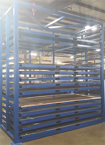

Weber Specialties added storage racks to handle sheet for the hungry laser cutter, and is looking at ways to add sheet remnants to its inventory-management system to better serve low-volume customers that may not require full sheets for limited part production. |
