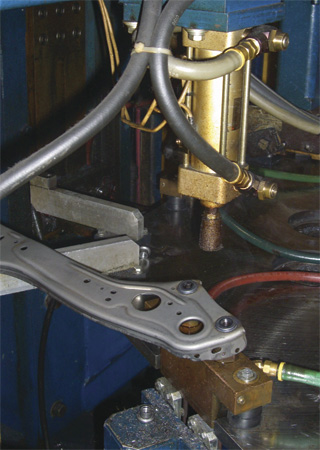

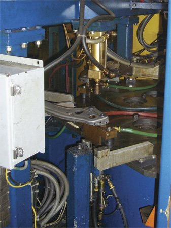

Metrican Stamping retrofitted this automated dial-index welding machine with MFDC technology, which delivers more energy to the welds and allowed the machine’s cycle time to be reduced from 9.5 sec. to 7.5 sec., increasing production rate by 101 parts/hr.
Early in 2009, Metrican maintenance personnel focused attention on problems with a specially designed automated dial-index welder that had come from its Canadian plant. Equipped with a 150-KVA single-phase AC transformer, the machine had proved marginal for the application. A single-gun machine with a rotary table, the setup was tasked with welding two critical nuts with ring projections to a General Motors seat component, and had been running at maximum capacity for several years.

The single-gun machine resistance-welds two nuts with ring projections to a General Motors seat component. With the previous AC welding system, electrodes were only good for about 40,000 welds; the new MFDC system enables the machine to run 200,000 welds prior to an electrode change (although just to be conservative, operators change electrodes after 150,000 welds). Annual expenditures for consumables has dropped by more than $10,700.
At Metrican Stamping Corp., the existing RoMan single-phase 150-KVA 60-Hz welding transformer was replaced with a new RoMan 320-KVA, 50-percent-duty cycle, three-phase MFDC power supply operating at 1000 Hz. In addition, the existing welder control was quickly converted with an MFDC retrofit kit (from Medar, a division of WTC).
Although the MFDC transformer is rated at 320 KVA, it’s physically smaller and lighter than the 150-KVA single phase-transformer it replaced, yet produces more secondary amps at a lower primary draw.
