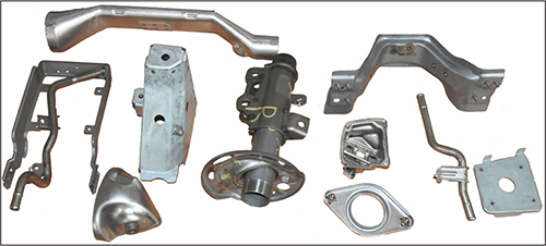

Although many MetalForming readers recognize resistance welding (RW) as a common value-added secondary operation, especially for customers in the automotive industry, many do not fully understand the process. That’s the goal of this new column. Recognized as the fastest and least-expensive process for joining sheetmetal parts, RW looks deceptively simple. Yet, failing to precisely control the numerous process variables can result in welds that may look good but fall apart under load. A properly made resistance weld should be stronger than the parent material.
Spot and projection welding are the most common RW processes; other subcategories include seam, butt and flash welding. In addition, RW machines can perform brazing and hot-upset riveting.

Developing a documented weld lobe of process variables (the range of acceptable parameters) and staying in the middle of that range should ensure quality. Metalformers can develop the weld lobe inhouse or outsource the task to a qualified RW lab.
In addition to careful parameter development, shops must pay close attention to proper part fitup to help ensure RW success. Improperly formed parts with built-in springback can rob the process of the required weld force needed to produce strong joints. Much like the old time blacksmith, RW is a forging process, and weld force is a critical variable that must be adjusted to suit various material thicknesses. Sad to say, it’s not unusual for our service techs to hear from customers that they have never changed the air-pressure gauge setting, which controls weld force.
In addition to using the proper weld-force setting, achieving good weld strength when welding higher-strength alloys often requires a welding machine with a low-inertia force-delivery system with fast follow-up to instantly forge the weld joint when it reaches the molten state.
To help ensure spot-weld quality, the operator of a press-type RSW machine deploys a specialized digital gauge to measure weld force—one of the three variables critical to achieving optimum weld strength.
Metalformers also should take care when programming the two other main process variables—weld current (in amps) and weld time (current-flow duration), measured in cycles. Both of these variables vary based on the application. And, since weld schedules are not readily available for most new alloys, careful R&D lab work likely will be required.
