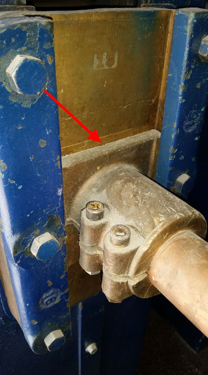

Also check the condition of the shunts. On most welding machines, the secondary current is conducted from the transformer to the upper moving part of the machine through a stack of flexible thin copper sheets called a laminated shunt (Fig. 2). Over years of use, these pieces of copper break off near the fastening points, which reduces the number of sheets left for conducting the welding current. If more than five percent of the sheets have broken off, replace the shunts. They are not expensive, and an RW-equipment supplier can produce an exact, and probably improved, laminated shunt.

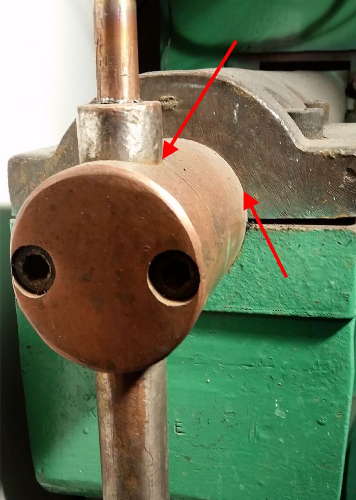

Fig 3 resistance welding water cooled electrode holdersFinally, check the areas where the electrode holders attach to the welding machine’s arms (Fig. 3). It is not unusual to see a holder that has been smashed with a hammer during “adjustment,” with that portion of rough surface pushed lower into the arm to conduct electricity. Remove the electrode holders and check for smooth, clean surfaces. If the holders are beat up, replace them. New ones are inexpensive, and you will gain power while eliminating water leakage where the electrode is installed.

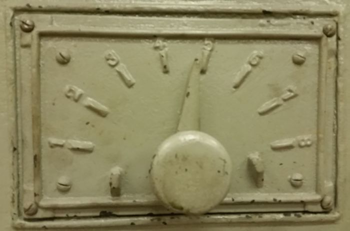

Q: We have only one RW machine in our plant, originally purchased to weld 12-gauge channels. We recently brought in a new project requiring welding of 22-gauge steel panels and drawers, and the machine is too large.  We have to set the weld heat at about 30 percent to create welds that do not expel metal out into the aisles. However, this low heat setting creates a very small process window for creating good welds—just a small change in electrode force or weld heat produces welds that snap off without making good nuggets. What can we do?
FIg 4 resistance welding tap switchHirsch: Unfortunately, the “one-size-fits-all” concept does not work well with RW machines. But you can try a few things. First, look for a large tap-switch handle, either on the side of the machine or mounted to the welding transformer itself, to adjust the secondary voltage of the welding transformer. Setting the tap switch to a lower number will reduce the welding current and should allow you to make better welds on thinner sheet metal; keep the weld-heat percentage setting no lower than 60 percent. To weld thicker sheet metal requiring a weld-heat percentage greater than 90 percent, turn the tap switch to a higher number (Fig. 4).
Unfortunately, some newer RW machines do not have tap switches. In this case, you might be able to reduce the secondary voltage by locating the internal terminals in the back wiring compartment of the welding transformer. First, turn off the power to the welding machine and lock out the disconnect switch. Then remove the back plate from the welding transformer and look for large studs inside, likely marked with numbers—the lower the number the lower the weld heat. Unbolt the wire attached to a higher-number stud and bolt it to a stud with a lower number.
If the welding transformer does not have these studs and has only one heat setting, the only other choice is to operate the welding machine on a lower line voltage. If the machine is rated at 440-460 V, connect it to a 220-V line (if you have one large enough). The machine now will generate about one-half the secondary current, allowing you to set the control to a much higher welding-heat percentage to provide a more robust and stable welding process. MF
