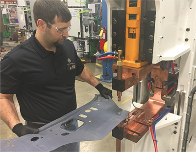

Fig. 2—A threaded nut is welded to a high-strength-steel stamping on a rigid-framed press-type protection welder.

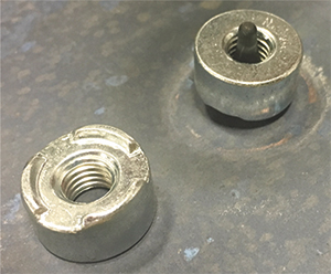

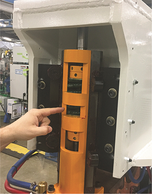

Fig. 3—This standard press-type spot welder features a low-inertia ram equipped with a spring for fast follow-up. The ram's cover has been removed to show the spring. Fig. 4—A "sausage-shaped" projection design on the fastener is recommended for welding to high-strength steel.
A properly sized press-type resistance-welding machine (not a rocker arm), with a rigid frame and a low-inertia ram with fast follow-up, will deliver the best results in applications involving high weld force, high weld current and a short weld time (Fig. 2). This welding schedule creates intense heat at the projections and allows the welding/forging process to take place rapidly—before the projections collapse and blow out.
In other words, success usually results from setting the machine to weld “hot and fast.” And, whether connected to a pneumatic or servo-actuated ram, the importance of using high weld force and a fast follow-up device, such as a spring built into the ram (Fig. 3), cannot be over-emphasized.

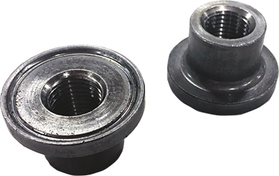

Fig. 5—A weld nut with a ring projection also works well when welding to high-strength steel, especially when a gas- or liquid-tight joint is needed.

With a suitable welder identified, the proper fastener geometry will make it much easier to successfully weld nuts and studs to hard, high-strength alloys. According to Ron Foreman, welding-lab manager for Buckeye Fasteners, a supplier of nuts and studs designed for resistance welding, the pointed “upside-down-pyramid” projection designs used for many years in mild-steel applications tend to collapse before a strong joint forms with high-strength alloys.
To prevent blowout of the projections before they sink into the high-strength sheet, he recommends choosing a fastener with three rounded “sausage-shaped” projections (Fig. 4). Also, when welding fasteners to thick material, Foreman recommends six projections positioned well away from the fastener’s self-piloting ridge. In addition, he reports that rounded 360-deg.-ring projection designs work well (Fig. 5), especially when the joint must be gas- or liquid-tight.
