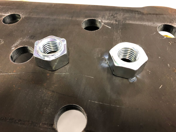

Successful PW for welding nuts to a substrate requires good equipment alignment to ensure the delivery of an equal amount of force, simultaneously, to all projections on the nut (Fig. 1). Also, the force-delivery system of the PW machine or gun must be able to move quickly as the projections collapse, maintaining full force—called fast follow-up. A large press welder not properly equipped, a sticking cylinder or a slow servo could cause problems.
Any variation in the projections on the nut will lead to inconsistencies. And, nut-feed consistency is imperative. If the feeder misplaces a nut, momentary misalignment can occur.
Force follow-up: As the projections begin to heat during welding and collapse, the weld head must maintain force and full pressure on each projection as it collapses. This ensures good, strong welds. If the weld head sticks, weld strength will suffer; in extreme cases, no weld and flash, expulsion or spatter may result.
Weld schedule: A proper weld schedule will help ensure the use of the recommended weld force, bringing the projections to temperature and forging the weld with the proper fast follow-up.

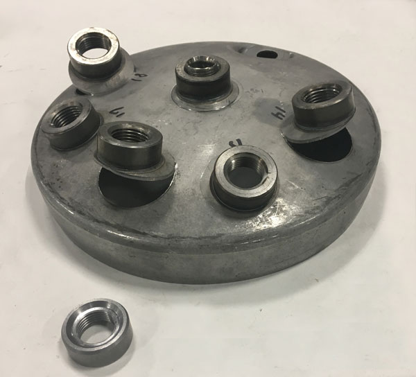

Projection shape varies due to the weld-nut manufacturing method, cost and final product-design requirements. Nuts generally are formed with three to six projections on one side; higher strength applications may require more projections. Projection shape also varies from pointed to rounded with various heights. The type of workpiece material also may dictate the projection style, as well as the weld schedule and the need for tempering (if working with high-strength steels).
How Do You Design a Projection for RW?
Projection size (height and diameter, (Fig. 2)) and design will depend on the workpiece material and thickness, and the location. Some PW does not require a specific projection design, as with cross-wire welding—merely place the two wires in contact at 90 deg. Two flat pieces of low-carbon steel, however, require a projection of some sort. MF
