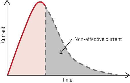

| Fig. 3—Weld current around the peak of the current waveform determines weld strength. Tailing current has no effect on the weld. |

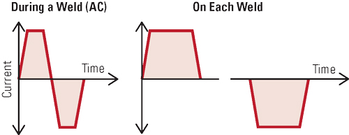

| Figs. 5-7—Precise repeatability of waveforms helps ensure high weld quality. |

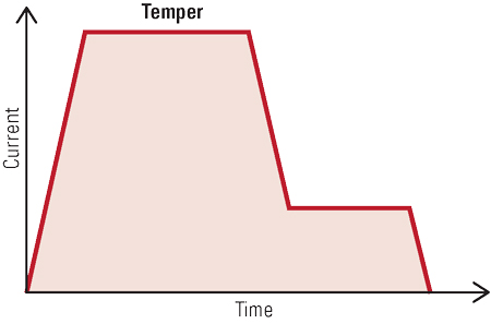

Fig. 1 shows waveforms of three welder types, all of which deliver excellent weld quality. As with Figs. 2 and 3, the green waveform depicts a mid-frequency direct current (MFDC) constant-current waveform with stable weld current. The red waveform depicts a standard CD welder yielding excellent welds by suppressing the heat effect to the work piece. The blue waveform depicts a variable-waveform CD welder combining the qualities of the MFDC and standard CD welders.

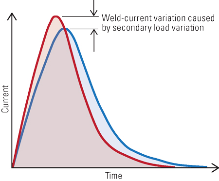

Load variations are not compensated for during the welding process, as depicted in Fig. 2. The result: variation in welding current at the peak of the weld.

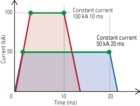

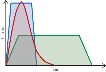

Weld current around the peak of the current waveform determines weld strength. Tailing current has no effect on the weld (Fig. 3). Without any type of current feedback in the conventional controls, exactly when peak current occurs remains unknown. Weld-current variation also can occur due to the lack of current feedback. Without feedback, the controls cannot compensate for the load variations during welding.Within the last 10 yr., newer control designs featuring active feedback systems have become available. These allow for current compensation during welding to correct current errors because of secondary-load variations, while the control itself creates a variable waveform that addresses issues that conventional capacitor discharge welders cannot. Fig. 4 illustrates the constant-current capability of the variable-waveform design.

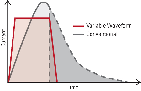

With this new control design, users enter weld-schedule parameters with a keypad. Weld current and weld time are simple numeric entries. The weld-current entry, capable of turning off after reaching peak current, saves energy, which can remain stored in the capacitive bank. The result: energy-cost savings and cycle-time reductions due to not having to wait for the entire capacitive bank to recharge.
The variable-wave control becomes possible by utilizing an MFDC to control the discharge of the capacitive bank, combining the best of two worlds: fast welding and the precise control and stable weld strength through constant-current feedback offered by MFDC technology. The result: excellent and repeatable weld quality.
