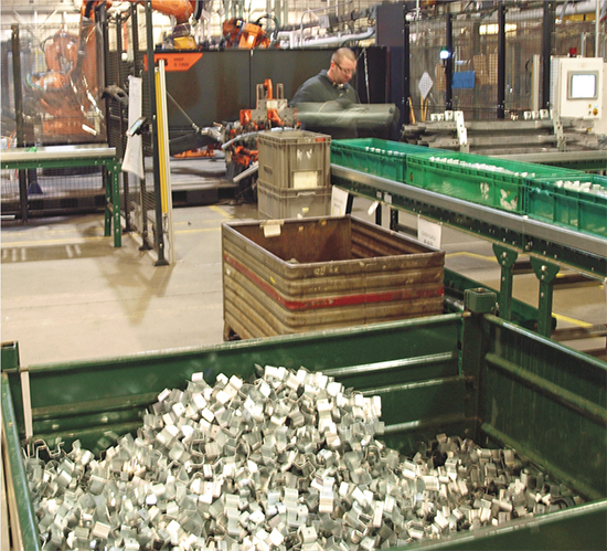

At the entry end of Wellington’s latest ABB robotic-welding cell, used to assemble bumpers, a series of resistance-welded subassemblies make their way down a conveyor belt. An operator loads the subassemblies into a large turntable positioner (seen here just over his right shoulder), which indexes the fixture assembly into the welding cell. The cell welds a reinforcement plate and an array of clips and nuts to the boron-steel bumper beam.

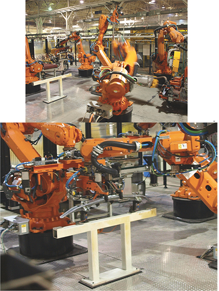

The first two robots (far right, top photo) in the bumper-assembly cell make resistance spot welds to hold the bumper components in place, functioning as tack welds for further welding operations. Then, three material-handling robots (bottom photo) take over, moving the assembly through a series of operations in stationary resistance-welding machines. The cell pumps out more than 100 bumper assemblies per hour.

Most recently, Wellington commissioned, in mid-2014, a five-robot assembly cell for robotic welding of bumper assemblies. Assemblies include a large hot-stamped, hat-shaped, aluminized (40 g) boron-steel bumper beam and a host of welded attachments—backing plate, brackets, nuts, etc. A lineup of nine manual pedestal resistance-welding machines feeds subassemblies into the huge ABB robotic-welding cell where five robots toil—two welding robots and three that serve as material handlers.
At the entry end of the robotic-welding cell, a turntable positioner indexes 180 deg. to swing the fixtured components within reach of a pair of spot-welding robots. These perform what amount to tack welds to hold the parts within their tight dimensional tolerances for the remaining dozens of spot welds made throughout the cell. Following this quick blast of resistance tack welds, the assemblies move to idle stations where material-handling robots swing in, pick up the subassemblies and move them through a series of stationary weld stations. This finely tuned ballet of robotic motion yields completed bumpers at a rate of more than 100/hr.
Specified equipment for the newest of Wellington’s robotic-welding cells: ABB newest models of large robots, IRB 6700 models rated to 235-kg maximum payload and boasting a reach of 2.65 m. ABB describes the seventh-generation robots as offering a 15-percent decrease in power consumption compared to previous models, along with a 20-percent reduction in total cost of ownership, double the time between service intervals and an average increase in speed/shortened cycle times of 5 percent.
“When we put the cell in, it immediately went into production,” says Richards. “We had zero learning curve, and thanks to ABB’s offline process simulation we immediately took off at 60 completed assemblies/hr. Within a few weeks, by further optimizing robot motion paths and speed/acceleration parameters, we ramped up to 100/hr., or more.”

Contributing mightily to this dramatic productivity gain is the integration, via the ABB robotic controls, amongst the robots, weld stations and positioner. “There’s a great deal of integration and electronic communication throughout the cell,” Richards says, “that allow the robots to work extremely close to one another, and to move in and around and the cell with minimal hesitation or distance between cell components. This lets us confidently and safely run the robots more quickly and without hesitation.”
