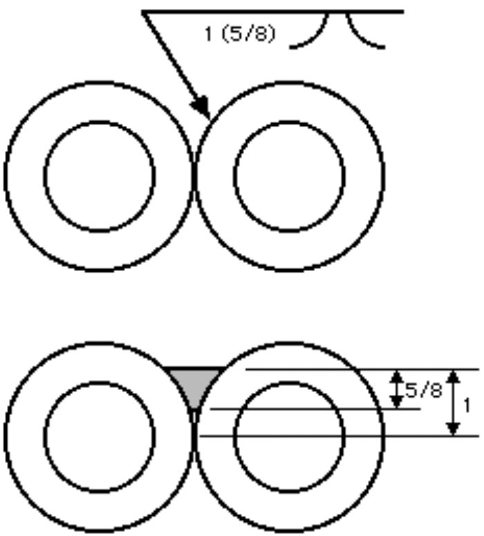

Flare-V Groove Flare-V-groove-weld
The flare-V-groove weld commonly finds use when joining two rounded or curved parts. The intended depth of the weld itself is given to the left of the symbol, with the weld depth shown in parentheses (Fig. 8).
Flare-Bevel Groove
Welders typically employ a flare-bevel-groove weld when joining a round or curved piece to a flat piece. Depth-of-groove As with the flare-V-groove weld, the depth of the groove formed by the two curved surfaces and the intended depth of the weld itself reside to the left of the symbol, with the weld depth shown in parentheses (Fig. 9). The symbol's perpendicular line always is drawn on the left side, regardless of the orientation of the weld itself.

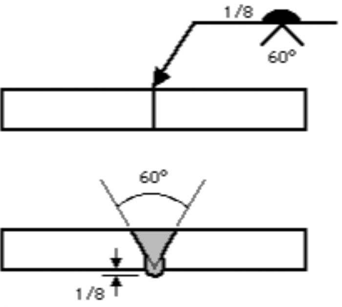

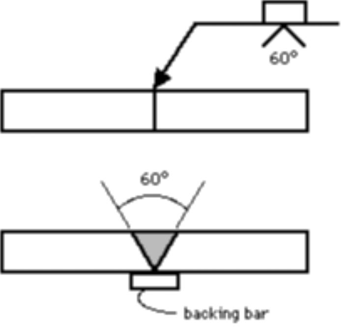

Melt-Through and Backing-Bar Symbols
Common supplementary symbols used with groove welds include the melt-through and backing-bar symbols. Melt-through-Symbol Both indicate the use of a single-sided groove weld for complete joint penetration. In the case of melt-through (Fig. 10), the root is to be reinforced with weld metal on the back side of the joint. The height of the reinforcement, if critical, is indicated to the left of the melt-through symbol, placed across the reference line from the basic weld symbol. When employing a backing bar its symbol locates across the reference line from the basic weld symbol (Fig. 11). Backing-bar If the bar is to be removed after welding, an "R" is placed within the backing-bar symbol. The backing-bar symbol has the same shape as the plug- or slot-weld symbol, but context should make the symbol's intention clear. MF
