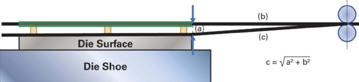

For dies with very little or no strip lift, the feed roll can close after the pilots have become fully engaged, with the stripper holding the strip securely against the die to prevent movement. This usually occurs near bottom dead center (BDC), or at 180 deg. of rotation.

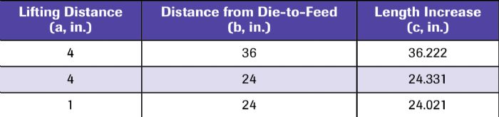

For dies with lifter rails, closure timing occurs later in the press cycle. Fig. 3 illustrates what occurs when the feed rolls close at BDC for a die with 4 in. of lifter travel. As the die closes, it must pull an additional 0.222 in. of material from the feed unit positioned 36 in. away. If the feed roll (or gripper) closes at BDC, this extra material becomes trapped between the die and the feeder. As the die begins to open, the strip material between the die and feed is forced to compress or buckle as it rises to its feed height. When the pilots exit the strip, the trapped material relaxes and pushes the strip 0.222 in. forward in the die. The feed then moves the coil to its next progression, resulting in a strip position that measures 0.222 in. too long. Should this problem be identified incorrectly, the press operator may begin making program adjustments to the feed to compensate for the timing error. The length error worsens should the die be positioned closer to the feed unit (at 24 in.) but is much less significant with a shorter (1-in.) lifting distance.
To avoid trapping material between the die and the feed, roll (gripper) closure must be delayed until the stock lifters return to their full up position. The feed must close completely before the pilots fully extract from the strip (point B in Fig. 2).

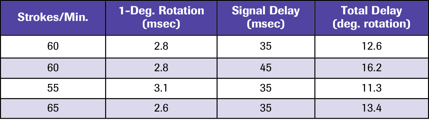

Fig-3-Die-to-feedtable 1For feed units that rely on pneumatic cylinders to lift and close the feed rolls or grippers, consider the delay time from when the signal is sent to open the feed and the actual time that the feed takes to open. The time required to charge the solenoid coil, activate the switch, exhaust air from one side of the air cylinder and pressurize the opposite side to lift or close the feed roll may take about 35 to 45 msec.
Assuming that a press running at 60 strokes/min. takes approximately 2.8 msec for the crank to turn 1 deg., we can evaluate the effects of pilot-release timing relative to press speed and lag time.
table 2Referring to Fig. 4, should the feed roll (gripper) be programmed to lift at 125 deg. in a press running at 60 strokes/min., it will not actually lift until 137.6 deg. assuming 35-msec lag time, or 141.2 deg. assuming 45-msec lag time. The same delay will occur when signaling the feed to close. If press speed decreases or increases, the pilot-release timing also changes.
