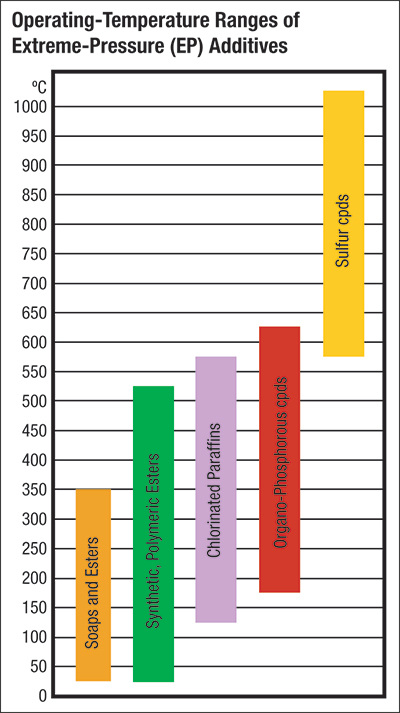

Lubrication: Lube type, viscosity, amount applied, location applied and the operating temperature range all impact part quality. Lubricants are formulated to work within specific processing-temperature ranges (see figure).
