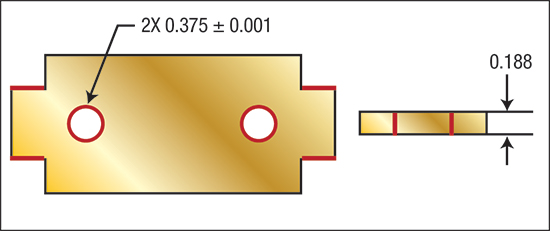

Consider the 0.188-in. mild-steel plate shown in Fig. 1; red coloring indicates punched holes and shear edges requiring shaving operations. To determine proper punch sizes and required cutting clearances for punching and shaving, follow these process steps.
The shave punch will determine final hole size. This punch usually is made to the nominal part print dimension (0.375 in.) or slightly larger to allow for wear. However, when specifying shave punch diameters, remember that the resulting hole size will be slightly smaller than the actual punch size, usually by 0.0002 to 0.0004 in. due to elastic recovery after shaving. So, in this case we specify a 0.3753-in.-dia. shave punch.

Simplified part
 Fig. 1—Simplified Part (shaved edges in red)

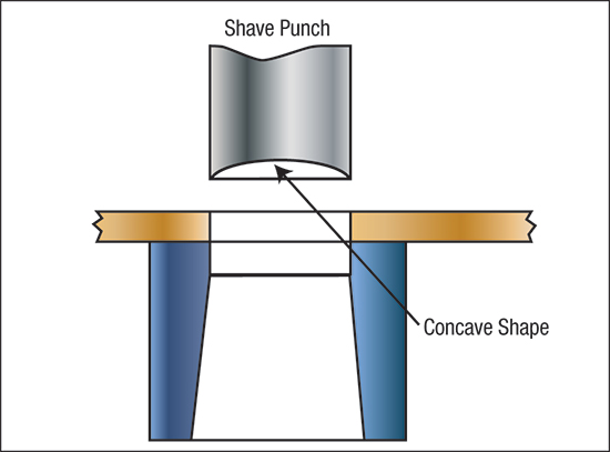

Concave Relief
 Fig. 2—Concave Relief

Shaving is much closer to a machining operation (cutting) than a stamping operation (punching). Therefore, consider adding a rake angle to the shave punch face similar to that found on a cutting tool. A conical shape on the punch face (Fig. 2) can accomplish this.
Establishing the proper back-rake angle for each shave application is somewhat of a black art that requires trial-and-error development. Some brass and bronze alloys do not require any back angle at all; mild steels, depending on hardness, may require a back angle of 10 to 30 deg.; and some aluminum alloys may need as much as a 45-deg. back angle.
