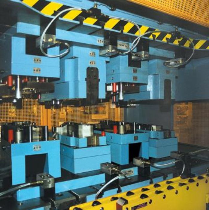

Quick die change (QDC), introduced decades ago, has become a staple of lean manufacturing in most stamping shops. Elimination of much of the lengthy press setup times and press downtime attributed to die change in the past advances just-in-time manufacturing. Still, many stampers are in the process of converting some operations to QDC, improving their methods of doing so, or speeding the process even more.
how-quick-die-change-is-changing-0QDC equipment itself—mechanical, magnetic, hydromechanical, hydraulic, spring, electromechanical, swing, sliding, swing sink, wedge, and traveling die clamps; ball, roller, hydraulic, and spring die lifters, bolster extensions, rails, controllers and aligners; carts, T-tables and power pallets; and controls—is being upgraded and their lines expanded to meet evolving requirements for speed and safety (see Fig. 1).

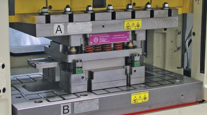

David L. Fischer, Hilma engineering manager, Carr Lane Roemheld Mfg. Co., pointed to production volume variation as a push for even faster die changeovers and economical die clamp and handling systems. “Shorter runs and more frequent die changes mean more press downtime. So die changes must be quicker.” He added this caveat: “But safety cannot be sacrificed for speed; they need safe clamping systems and ergonomic die exchanges.” (See Fig. 2.)
how-quick-die-change-is-changing-2Chris Keahn is North American sales manager at Tecnomagnete, which makes quick-change magnetic clamping only. He concurred that accelerating die changeover time is still a challenge. “Speeding up quick die changeover time is the main reason people come to us.”

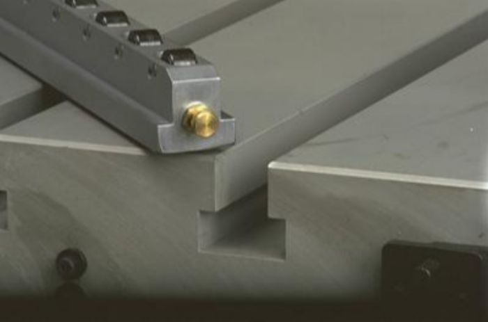

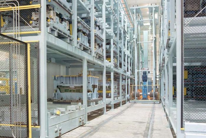

how-quick-die-change-is-changing-3Automated storage and retrieval systems help stamping companies manage die storage and handling issues too (see Fig. 3).
Fischer, Hilma: We have a variety of products that can provide custom clamping and handling for most applications, with a mix of standard products.
Newer components include smaller and more economical electrical and pneumatic power units, suitable for small and midsize QDC systems and presses.
Additional die handling products include hydraulic or spring-actuated ball and roller lifters. The positions and spacing of balls and rollers in the lifter bars can be adjusted to fit the application. This can greatly reduce costs when moving lighter dies. Ergonomic hydromechanical manual clamps, with clamp force indicator pins, can provide high clamp forces and very little tightening torque.
how-quick-die-change-is-changing-4Keahn, Tecnomagnete: We have reduced the thickness of our magnetic plates. When retrofitting a press with magnetic clamping, we can now minimize the amount of daylight the plates displace.

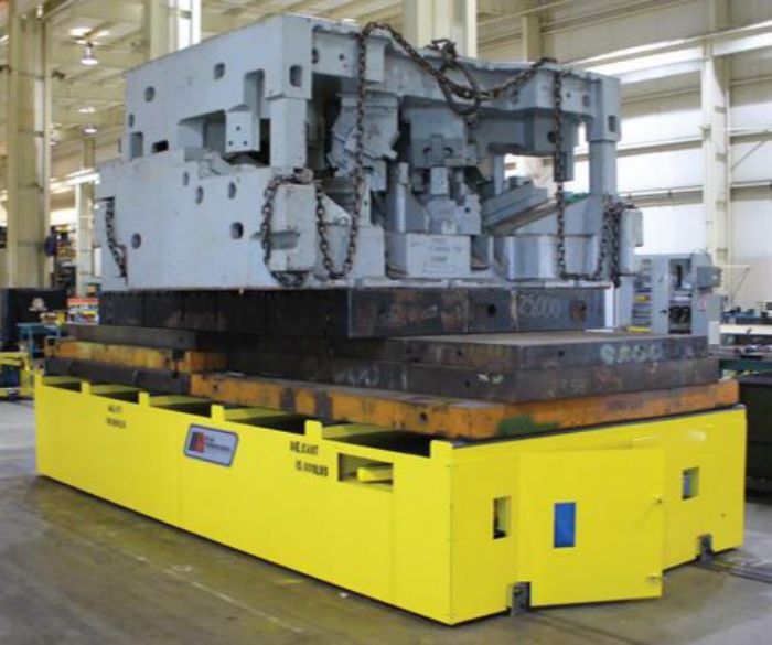

Herriges, Remington, Serapid: Die lifters often can help cut adjustment time, and easily adjustable or fully automated clamps can simplify the setup. Other options are die subplates, bolster extensions, and a die changer (see Fig. 4).

Rogner, Atlas: We support many types of upper die clamping systems. Generally, hydraulic, magnetic, or manual upper clamping is used (see lead image). A detailed cost-benefit analysis is required to evaluate clamping methods. In addition, safety and plant personnel involved in the die change process should play a role in the decision-making.
how-quick-die-change-is-changing-5Regarding die transporting, we see a significant increase in interest in trackless die transporters. Die lifters are available in spring, pneumatic, and hydraulic models (see Fig. 5). These are used based on die weight and bolster configuration.

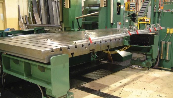

Fischer, Hilma: We work directly with the user to customize a system for their needs. This includes types and quantities of clamps, die rollers, die supports, pumps, and valves (see Fig. 6).
Keahn, Tecnomagnete: A wide range of clamping devices are available these days, but we specialize in magnetic clamping. I commonly see die lifters being used with our plates to allow for quick removal and the ability to line up tools quicker by adding locating holes.

Herriges, Remington, Serapid: The most complete—and initially the most expensive—option is a fully automated system that can move dies from storage to the press, clamp them, take out the die that’s no longer needed, and store it while staging the next die at the press, all without operator intervention. Typically considered with greenfield sites, or completely new plant construction, this system removes a lot of the potential for error, makes the best use of the shop floor, nearly eliminates wasted internal time, and often provides the best savings over time.
