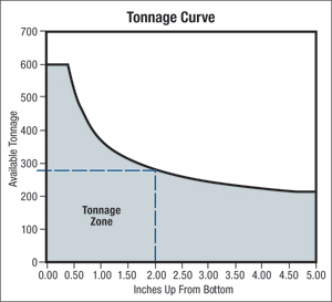

The tonnage rating of a press is the maximum
Tonnage Curve
load that can be exerted in continuous operation without causing damage to the machine structure or to its drive system. But it is important to realize that the force available to carry out work (blanking, drawing, forming, etc.) decreases in mechanical presses as the working distance above the bottom of the press stroke increases. This occurs because the lever-arm angle—the relationship between the crankshaft angle and the pitman—has reduced mechanical advantage higher up in the stroke. This is commonly referred to as “derated tonnage.”

After calculating the required blanking and drawing forces, compare the results with the derated tonnage for the press being used. The tonnage curve on the previous page illustrates the concept of derated tonnage. In this example, a 600-ton press deep drawing 2 in. above the bottom of the press stroke has less than half the rated press force available to carry out the drawing process. Therefore, calculated tonnage must be less than this derated tonnage.
