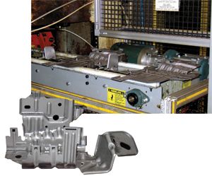

Oakland Tool and Manufacturing (OTM), Fraser, MI, part of an umbrella group that also includes Madison Die and Engineering—a prototype and die-build company—and medium-volume stamper Gaylord Precision Tool, sits in the shadows of several now-closed automotive tier stampers. OTM remains viable because of several strategies, including paying attention to employing best practices in running production parts.
OTM supports the Tier One and Tier Two markets with medium- to high-volume stampings, including stamping of one key structural component for the Ford F-250 and F-550 trucks. OTM also performed prototyping and development work for the program.
Once prototyping activities were completed, OTM’s customer was to market-test the part for production. In order to be competitive and secure the business, OTM evaluated material savings from nesting the blanks in an offline operation, hand loading the blanks into a blank feeder, and running the process with a mechanical transfer system. It already had a 300-ton mechanical press with an 84 by 48-in. bed and a 16-in. stroke. It sought an inexpensive method to apply transfer automation to the press and to present blanks to the automation. Working with HMS Products Co., OTM purchased a hand-loaded blank feeder and a Series 500 full-mechanical transfer system, with part-specific engineered finger tooling integrated into the die design.

Design collaborations between OTM and HMS overcame these challenges and resulted in a line that operates at 15 strokes/min., and which has produced 375,000 stampings/yr. for several years now.
Says Jim Tomlin, OTM engineering and tooling manager: “The transfer and loader unit have exceeded our expectations. Aside from lubrication and the most basic preventive maintenance, this system just runs. Other benefits include built-in error proofing of the finished parts, and less downtime than many of our progressive applications.” MF
