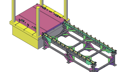

A table-mounted push-pull system allows for the elimination of wandering and popping. Such systems can be sized for large loads, with swing-aside bolster extensions creating an aisle between the press and die-change table. |

Table-Mounted Push-Pull Systems
Description: Mounted table, usually on some type of roller bars or lifters for smooth movement.
Advantages: Allows for the elimination of wandering (side-to-side movement of the chain as it moves forward) and popping (when the chain does not stay down during the whole length of the stroke). Such systems can be sized for large loads, and swing-aside bolster extensions create an aisle between the press and die-change table.
Disadvantages: Requires dedicated floor space and there is no prestaging of the die.
