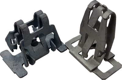

Little parts are a big business for Stanley Engineered Fastening, a Stanley Black & Decker company, with global operations in Asia, Europe, South America and North America serving a range of industries. High-volume clips for a long list of major automotive companies, made at its 133,000-sq.-ft. Montepelier, IN, facility, represent an important part of Stanley Engineered Fastening’s product portfolio.

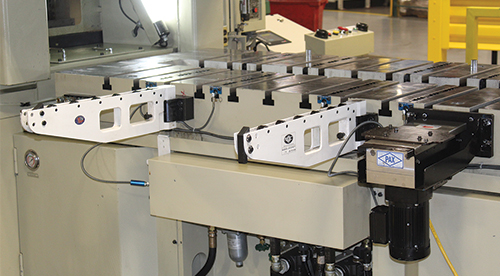

A swing-down bolster extension enables easy retrieval by die-transport vehicles.

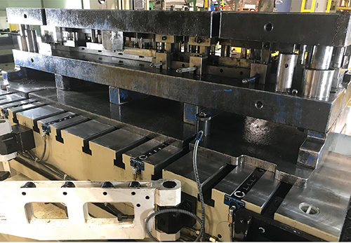

“Our stamped metal fasteners require long dies with many stations,” says Gray, explaining that the Seyi press and its 84-in. bed makes possible the progressive dies required for the complex bends, while the QDC system facilitates faster changeover between part runs. The QDC system, with its hydraulic in-bolster die lifters, bolster extension and hydraulic die clamps, has enabled Stanley to reduce setup times from 52 min. to just 31.
The hydraulically actuated die lifters lift and assist movement of the dies on the press bed. Dies are rolled from the press bed onto the removable, swing-down bolster extension for easy retrieval by die-transport vehicles. And, hydraulic die clamps mount in T-slots on the clamping surface.
Achieving faster die changes also meant standardizing plates, bolts, clamps, etc. “There can be 20 different ways to clamp a die,” says Gray, “so we must keep everything standard so that we don’t lose time looking for bolts and clamps. All of our QDC efforts are important because we’re producing many different parts of varying quantities—from as few as 5000 to as many as 300,000.

High-retention metal fasteners for an automotive airbag are among the many mini automotive parts produced by Stanley Engineered Fastening in Montpelier, IN.

“Safety is an important factor when it comes to changing dies,” says Defrees, citing the system’s clamping technology as an example. “With this system, hydraulic pressure is used to stretch the bolt. Then it’s screwed tight with air pressure maintained on the bolt. This is safer than a straight-up hydraulic system where, if the hydraulic pressure fails, you lose the clamp.
“As for the lift station,” he continues, “the bolster extension allows the operator to put the die extension on while standing 2 ft. from the press, resulting in less risk of damaging the press when setting the dies or the plate that attaches to the bottom of the dies. Another safety feature: a pressure switch that prevents clamping of dies while the lifter is raised. The lifter must be mechanically lowered before dies can be clamped.”
