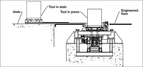

This sideview shows how a trolley and elevator setup helps ease transport of tooling onto press bolsters, which sit 6 in. below floor-level.
The targeted manufacturing process includes three press cells, with two cells containing two presses each and the third cell outfitted with a single press. The plan: Install one die changer to service each cell. The dual-press cells, as mentioned, feature bolsters on a common height 6 in. below floor-level.
After the upgrade, personnel assemble tooling elsewhere in the shop, transport it by cart to the press cell, then place it on the QDC system’s trolley. The trolley then transports the tool to an elevator within the press cell, which raises and lowers it, thus eliminating the issue of the 6-in. height difference from floor to bolster. The tool then moves into the press bed, is clamped and ready to use. Changeovers occur within minutes, although other associated processes extend the total time needed.
The tooling transfers to and from each press bolster on lubricated, replaceable brass wear strips via Serapid Dual RollBeam 60SC chain units mounted to each press bed. The elevator uses a single Serapid 100R LinkLift column, more than capable of lifting the 16,000-lb. tools. The trolley travels on and off of the elevator on tracks via a Serapid 40PS chain that positions the tool either in the aisle or on the elevator.
The weight of the system and tools distributes across the floor of the press pit and is supported by existing concrete piers in the pit. With the exception of the clamps, the entire system is nonhydraulic and completely electromechanically powered.
