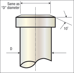

Reducing the head diameter or chamfering the contact surface on the head (Fig. 2)
fig. 2 minimize compressive
 Fig. 2
will minimize compressive loading and flex at the unsupported outside diameter of the head at initial punch impact.
Applying a shear angle to the punch point will help reduce the forces on the punch body and the punch head.
Reducing the hardness of the backing plate is another viable solution. The backing plate must adsorb the punch impact adequately without cracking, breaking, permanently deforming or severely deflecting. Softer and tougher tool steels such as S-7 are good candidates for backing plates.
When all else fails, using a punch with a larger body usually will reduce head breakage.

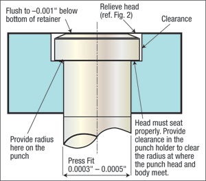

Proper fitup between the punch body and punch holder is essential to prevent punch pumping, which basically acts as a battering ram on the punch head. Good design and build practices should include the following (see Fig. 3):
 Fig. 3
• Make the body of the punch a slight press fit into the hole in the retainer. A press fit between 0.0003 to 0.0005 in. should be sufficient.
• Ensure that the head is fully supported and seated into the counterbored hole in the retainer.
• Ensure that the retainer is cleared for the radius connecting the head to the shank. Provide just enough clearance for the radius. Avoid excessive clearance.
• Ensure the head of the punch does not protrude past the bottom surface of the retainer.
• Fit the punch so that the bottom of the head is as close as possible to the bottom surface of the retainer, but no more than 0.001 in. below.
