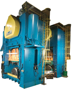

Gm operates 70 stamping presses to produce a variety of Ag parts.
GMP operates 70 stamping presses to produce a variety of Ag parts, from precise and close-tolerance transmission parts to large deep-drawn parts formed on this 1500-ton transfer press.

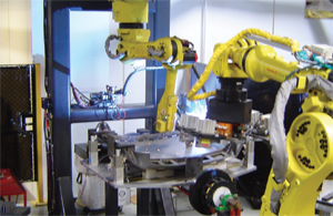

GMP converted a fabricated door assembly for a skid steer into a set of stamped components
GMP converted a fabricated door assembly for a skid steer into a set of stamped components that now are robotically welded in this production cell. One robot in the cell acts as a material handler, holding and manipulating the parts—including the heavy, 173-lb. drawn shell, of 6-mm-thick cold-rolled steel—while a second robot, mounted overhead, performs the welding operation, adding 16 parts to the door.

Mallmann describes one significant collaborative project in which GMP converted a fabricated door assembly for a skid steer into a set of stamped components that now are robotically welded on the GMP production floor. “One robot in the assembly and welding cell acts as a material handler, holding and manipulating the parts—including the heavy, 173-lb. drawn shell, of 6-mm-thick cold-rolled steel—while a second robot performs the welding operation,” he says.
Redesigning the assembly with stampings—a drawn shell for the door skin, produced on the firm’s 1500-ton tandem presses, and several stamped brackets—rather than fabricating the parts provides dramatically improved dimensional repeatability. “The dimensional stability achieved by deep drawing the door skin allows us to employ robotic arc welding for assembly,” says Mallmann. “We began working on this project with our customer fours years ago, and it’s now been production since 2008. The appearance of the door is improved, and we deliver the door as one piece to the assembly line rather than two separate fabricated pieces, simplifying the assembly process for our customer.” MF
