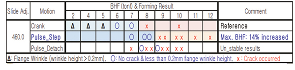

The company was interested in studying the effects of different motion profiles on material formability, with its draw testing performed by a 250-ton Simpac direct-drive servo press featuring a 250-mm stroke and capable of speeds from 1 to 40 strokes/min. The press, with an installed hydraulic die cushion, can operate in crank, pulse-step or pulse-detach mode. Drawing was conducted using a rectangular blank to form 50-mm-dia. cups.
In its tests, Simpac found that using pulse-step motion produced 8 tons of blankholding force whereas crank motion produced only as much as 7 tons—a 14 percent enhancement. Using pulse-detach motion produced mostly breakage. Examining friction-reduction effects, the tests found that the effects of the surge in die-cushion pressure were less than the friction-reduction effect in slide motion, while the opposite held true in pulse detach.
