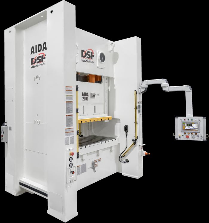

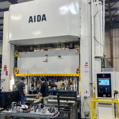

Aida-America partners with A-G Tool & Die, Dallas Industries and Pax Products, Inc. to demonstrate a 200-ton straightside servo press. The two-point, direct-drive DSF-N2-AB servo press is part of a full progressive-die production line stamping parts. It includes Aida’s Allen-Bradley servo control system, locally developed, manufactured and supported by a team of Aida controls engineers based in Dayton, OH. Standard control-system features include Allen-Bradley GuardLogix; user friendly swing-arm-mounted 12-in. color touchscreen; optical run buttons for ease of use; and handheld step-feed, slide-motion control for reduced setup time.
As with all Aida servo presses, the DSF-N2-2000AB includes an Aida-designed and -built low-speed, high-torque servo motor specifically manufactured for stamping-press applications. It combines the rigidity of a unitized frame with the flexibility of freely programmable servo motion. DSF-N2-AB-series presses are offered in 200- and 300-ton models. Additional standard DSF-N2-AB features include NEMA 13-rated floor-standing cabinets with flexible placement options; pneumatic safety brake integrated with safety controller for an additional, redundant safety layer; full-length, six-point slide-guide system; and recirculating lubrication system that provides clean oil in metered amounts to all bearing points.
