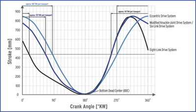

Fig. 1—Motion characteristics of various mechanical drives

Conventional mechanical presses feature a variety of drive-design options, including screw, link, knuckle-joint and eccentric, and operate with a variable stroke rate. However, time-travel ratios are fixed, even with an option of adjustable stroke. Therefore, the slowest part of the forming process determines the overall cycle speed and subsequent production rate. This can, in some cases, compromise efficiency. Optimizing production rate and forming with a mechanical press requires development of a variable time-travel ratio for the slide.

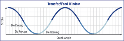

Transfer/feed window
Fig. 2—Motion curve for a traditional eccentric-drive press, where speed drops at BDC and TD.
Each type of mechanical drive has a unique motion characteristic related to its mechanical response to the drive motor (Fig. 1). With a conventional eccentric drive, slide motion travels a sinusoidal curve. Slide speed decreases before bottom-dead center (BDC) and top-dead center (TDC), and increases during closing and opening. Tonnage around BDC increases with constant motor torque, which suits the forming and transfer process in general. Optimizing this basic motion can improve efficiency.

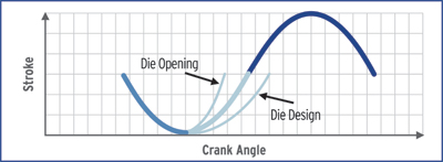

Fig. 3—The die-process stroke segment—timing is influenced by in-die operations.
During the die segment of a stroke, the goal is to adapt to the best possible forming speed for a particular part while considering in-die functions such as spring and cam actuation. Optimizing forming speed allows stampers to improve process reliability and part quality (Fig. 3).
During the die-opening segment of the stroke, the goal is to create accessibility as quickly as possible to avoid losing time in the full press cycle. However, in-die functions such as spring and cam actuation might limit maximum opening speed. The ability to manage opening speed within the cycle contributes significantly to overall process efficiency (Fig. 4).
