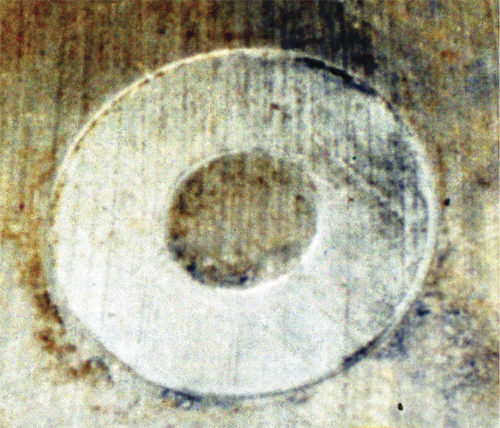

Fig. 1—A die shoe imprinted with a setup-block mark. This condition can be caused by improper heating used to free a press stuck on bottom.
In addition, when conducting plant audits, finding upper die shoes imprinted on the side of the press (Fig. 1) requires further inquiry. Inspectors can detect this condition visually or by feeling with a finger, and then find out if the press has become stuck on bottom and, if so, then learn how the condition was corrected. If the tie rods on just one side of the press were heated, they will have yielded and will remain loose. This will cause the upper-shoe imprinting problem on one side, as well as other problems.

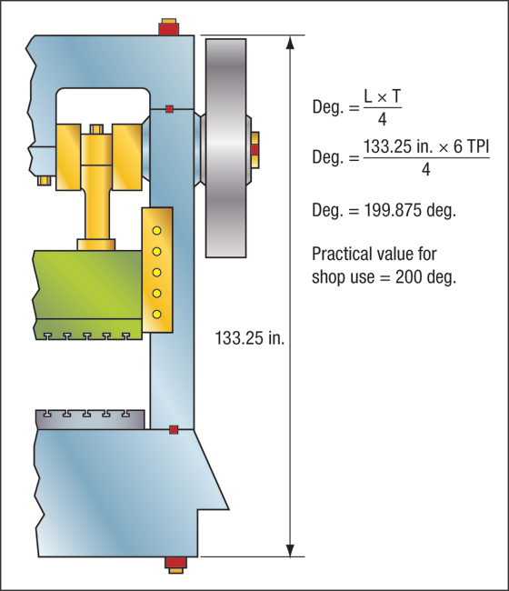

Fig. 2—Stampers can use this practical shop formula to determine the required degree of tie-rod preload.
…of the press tie rods is essential to ensure the proper operation of a straightside press. Most press service manuals explain the correct procedure. It is very important to tighten each tie rod correctly and equally. An accepted practice throughout the industry has been to prestress press tie rods to 0.0007 in./in. (0.0084 in./ft., or 700 microstrain). The tensile stress developed in a mild-steel tie rod at this strain level is approximately 20 ksi. If heat is used to shrink the tie rods, actual stress will be somewhat less once the press members have cooled, due to the elasticity of the members held in compression.
Fig. 2 illustrates the application of a practical shop formula used to obtain the correct tie-rod preload. The constant “4” is universal and is not to be confused with 4 TPI (threads per inch of the tie rods). Stampers should use this formula to determine the amount of rotation needed for each nut (200 deg.); measure the required number of degrees with a protractor and mark it with chalk. If the top nuts require adjustment, the tie rods will need support. The tie rods then can be heated and the nuts adjusted.

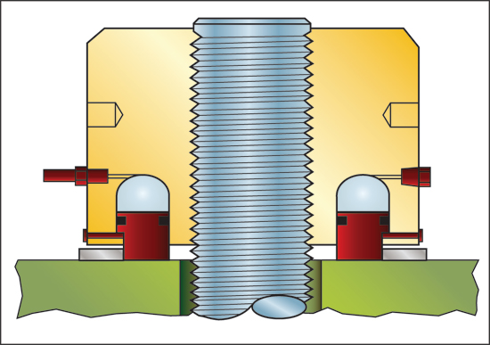

Fig. 3—This sectional view illustrates installation of hydraulic tie-rod nuts.

Note: Some presses feature hydraulic tie-rod nuts (Fig. 3). The hydraulic nuts are tightened up simultaneously and pressure is applied. Once the annular pistons have lifted, split shims are inserted and the pressure is released. MF
