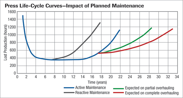

The service life of several common components (mechanical and electrical) recently has plagued the uptime of several press shops. Such components should be assessed for future obsolescence (see the table, Suggested Components to Assess for Planned Obsolescence).

It is important for NAFTA-region press shops to act now. The first step to avoiding unplanned downtime is to start with an equipment assessment by a press expert for the entire operation. From this assessment, create a maintenance plan that identifies common problem areas and anticipates the need for part or subsystem replacement. By using this strategy, companies can plan downtime to repair parts that may become at risk during high-output periods. In fact, this enables service providers to preorder parts with long lead times, and schedule time for press rebuilds or overhauls for outdated components.
Proper planning prevents expensive panic, so plan for the future by conducting routine PM inspections to assess your vulnerability to obsolete press-system parts. This is not a new concept; the approach has worked in the past and has reduced the amount of lost uptime. Equipment assessment is a part of continuous improvement, allowing a company to define critical areas and develop an action plan to reduce risk. MF
