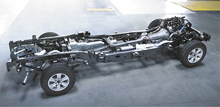

One important note: The F-150 story is not all about aluminum. The new truck, underneath its skin, has what Ford refers to as the F-150’s strongest frame yet. Comprising 75-percent high-strength steel (20 percent is 550-MPa yield strength, and 55 percent is 340-MPa yield strength), the frame accounts for nearly 10 percent of the truck’s overall weight reduction.

| Any discussion of the success of the new F-150 must include its high-strength-steel frame, responsible for 60 lb. of weight reduction. There are a few ‘firsts’ with this new frame, including the use of rollformed parts and a patent-pending 12-corner stamped crush horn. |
