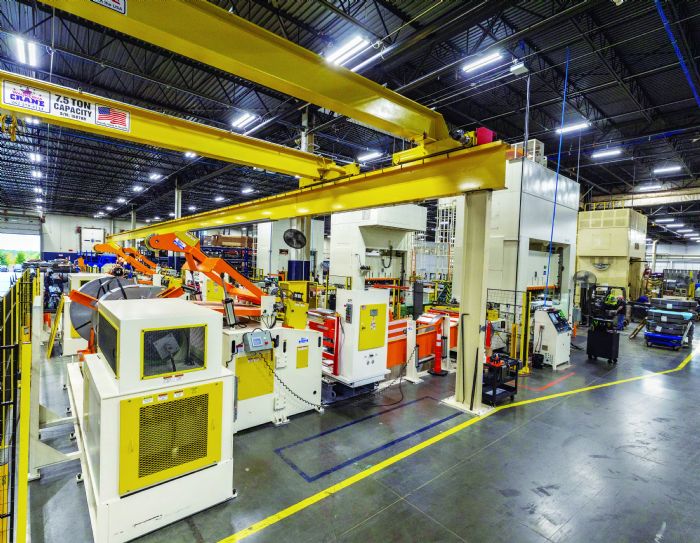

The 660-ton Seyi press installed at Kapco features a 145 by 60-in. bed, while 440-ton presses have 120 by 60-in. beds. All are equipped with Wintriss Smart Pac Pro controls and Dallas space-saver servo feed lines with pull-through straighteners. One of the smaller presses runs a 36-in. feed line, while the second can feed coil to 48 in.; both have 20,000-lb. coil capacity. The big press runs coils to 48 in. wide with reel capacity of 30,000 lb.
“We also added telescoping exit part conveyors, a very nice feature especially as it relates to die changes,” shares Knepp. “And, with the controls and feed lines, we’ve tried to build in some synergies, making it easier on the workers on the plant floor and for our maintenance team.”
Workforce development is key at Kapco, ensuring that operators know more than just what buttons to push and when. “We train the operators not only on the ‘how,’ but the ‘why,’” Knepp says. “We want them to understand why we set up a straightener a certain way, how we develop the pilot openings and other feed-line parameters. There’s a lot of teaching and training that went along with the acquisition of these new press lines.”

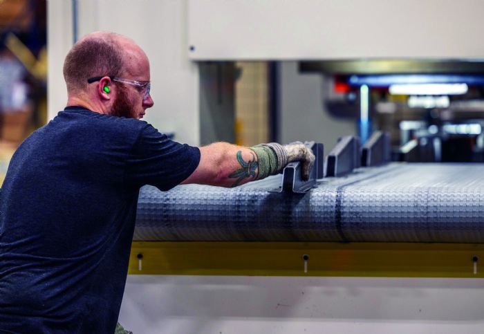

Unique to the press lines: the use of sensors on the part-out and scrap conveyors. “The presses often run nonstop full shifts,” Knepp says, “and we wanted to mistake-proof the lines in case an operator or the setup team forgets to switch on a conveyor, in order to protect the tooling. A simple mistake such as that could put us in a world of hurt and create a huge amount of chaos. Sensors in the conveyors proactively avoid those issues.”
