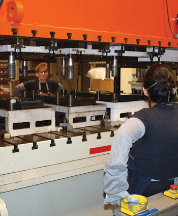

 Electrolux’s two new Stamtec presses feature fabricated box-frame construction and four full-length steel tie rods prestressed to 150 percent of press capacity. Eight full-length 90-deg. gibs, with nickel-bronze wear plates, guide the slide. Each press also boasts a high-torque low-inertia clutch and separately mounted air-released spring-actuated brake, automatically synchronized. Dual-valve automatic hydraulic-overload protection systems protect each side of each press individually from overloads. Also, each press includes a set of four die safety blocks interlocked to the press controls to prevent inadvertent operation while the safety blocks are in use.
Press specifications: 14-in. stroke; 20- to 40-strokes/min.; 144- by 60-in. bolster and slide area; parallelism (slide to bolster) of 0.001 in./ft. or less; deflection of 0.0015 in./ft. or less right to left and front to back, with two-thirds of the bed area symmetrically loaded.
Omnilink 5000 press and automation controls on the presses, from Link Systems, provide the plant the opportunity to eventually evolve from manually fed operations to automatically fed. The units offer clutch-brake control, auxiliary-systems control, die protection and process monitoring, signature and tonnage monitoring (which Electrolux hopes to eventually use to gauge burr height and trigger die maintenance), and automated setup of counterbalance, die cushions and shut height.

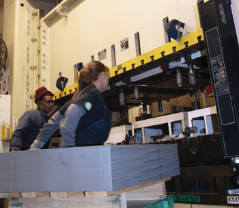

Starring at the new Electrolux stainless-steel press shop are two new Stamtec presses—600- and 400-ton capacity, 144 by 60-in bed. They run the stainless-steel parts five days/week, two shifts/day. A team of five works at each press—four press operators who manually transfer blanks through the die sets, at 300 strokes/hr., and a material handler/inspector.
