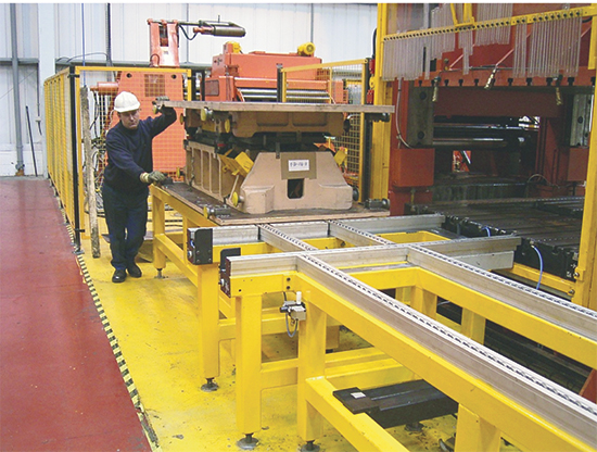

Locating dies on the bolster centerline quickly and accurately is an essential quick-die-change (QDC) task. The alternative to having a good method for centering your dies is time wasted prying and bumping dies into approximate location, often to find that jobs run scrap in spite of laborious trial-and-error efforts.
Good QDC centerline locating methods exist, including use of centerline keys and locating pins.

Large Centerline Locators
Large, typically 3-in. or larger locators find use for moving-bolster applications to accurately locate the lower die shoe or subplate. Many new presses with moving bolsters are fitted with these locators.
Fig. 4—Centerline locating pins must fit snugly. |
Good practice: Bolt the pins to the bolster and carefully lower the die over the pins for setting. Fig. 3 shows a plan view (looking downward) of the bolster, pins and lower die. Accurate location requires that the pins have only a small clearance in the lower die, typically 1⁄16 in. (Fig. 4).
Accurate location is essential when using automatic die clamps. Transfer-press fingers as well as tandem pick-and-place automation require exact location to function without trial-and-error adjustment with every die set. You need sufficient clearance to avoid binding when lifting the die from the bolster, but not so much as to cause inaccurate location. MFTechnologies: Stamping Presses, Tooling
