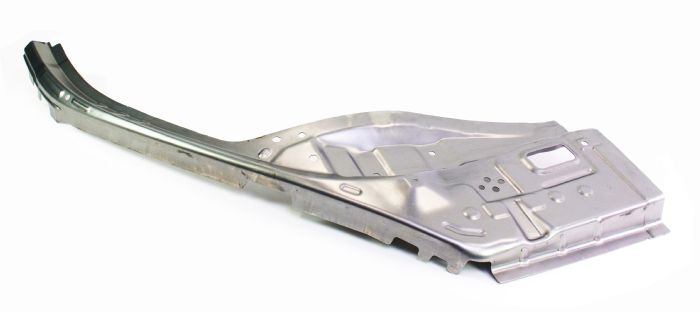

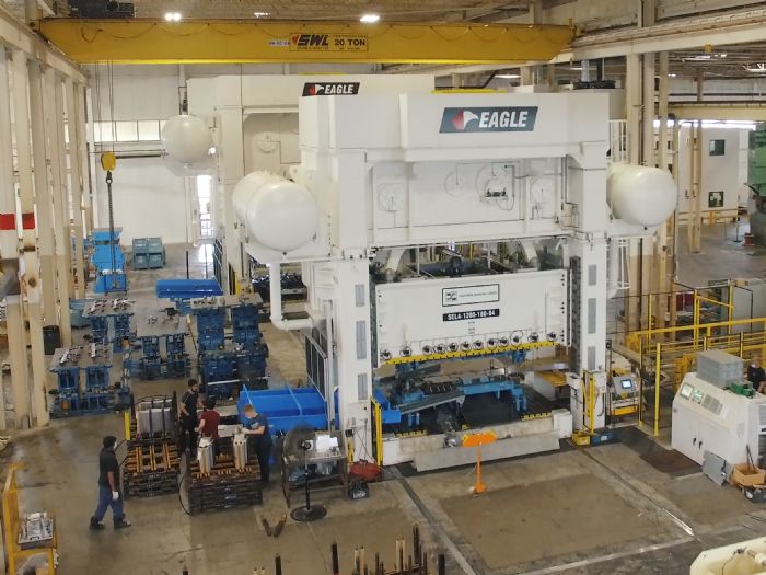

In fact, prior to bringing in the larger prog-die press, PSG had quoted a new program for a customer that included tools larger than the 144-in. press could handle. “When we won that job, for body-in-white underbody parts,” recalls Abt, “we had to buy the bigger press. Shortly thereafter, we were awarded transfer work for the same platform that pushed us to invest in a larger transfer press as well.”

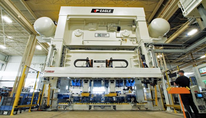

That transfer press, a 2500-ton eccentric-drive Eagle with 240 by 96-in. bed and 30-in. stroke, hit the production floor in May 2020. It’s outfitted with a Linear Transfer 600-lb.-capacity (part and tooling) transfer system and destacker. Like I said, the big three—bed size, tonnage and automation. Dual rolling bolsters accommodate quick die changes.

“Before we brought in the big transfer press,” says Abt, “we formed larger, heavier parts through a hand-transfer line of 1000-ton presses with 132 by 84-in. beds. Now we can make these parts under one ram, and with the required tonnage and press automation that creates a significant competitive advantage.”
In addition, the transfer system quickly can be parked out of the way for die changes. It offers an 84-in. pitch, 36-in. clamp axis, and 24 in. of lift. Included are motion profiles for 2D, 3D, crossbar and pick-and-place motion, as well as recipe-optimization software built into the HMI.
When PSG commissioned the transfer press, it already had 12 new dies queued up; no existing tools were moved to the press. It’s rated by Eagle for a maximum stroke rate of 22 strokes/min.; Ladouceur and his production team have it running to 20 strokes/min.
For the blank feeder, integrated to the transfer automation, PSG went with a unit capable of handling blanks from 6 by 20 in. to as large as 48 by 84 in., and a maximum stack height of 24 in. And, it can feed double unattached blanks as well, in parallel or in series and with a minimum distance between blanks of 8 in.
“With the ability to manage two separate blanks simultaneously through the press,” says Ladouceur, “we’ve been able to take a job that would have run one blank at 22 strokes/min. and instead stamp two blanks at 15 strokes/min., the equivalent of running at 30 strokes/min.”
