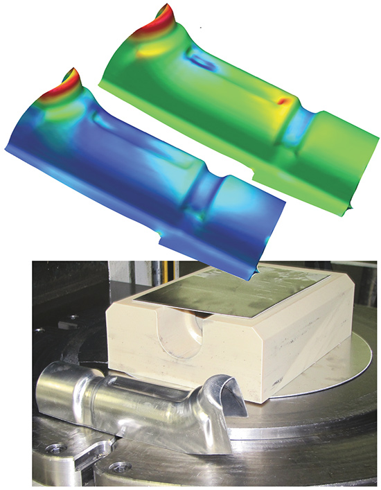

 Here’s another example of marrying forming simulation and 3D printing of hydroform tooling. Shown are Pam-Stamp models (thickness and major strain) of a formed aluminum (6062-O, 0.040 in. thick) heatshield, and the resulting 3D-printed form block created on a Stratasys Fortus 400mc printer.

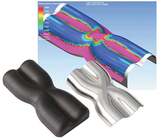

 Shown are sheet-hydroformed parts and their related 3D-printed tools, manufactured from Ultem 9085—a high-performance fused-deposition-modeling thermoplastic from Stratasys.
Sheet hydroforming often allows for the formation of multiple parts in a single press cycle. Shown are sheet-hydroformed parts and their related 3D-printed tools, manufactured from Ultem 9085—a high-performance fused-deposition-modeling thermoplastic from Stratasys. The material can withstand hydroforming pressure to 20,000 PSI.
While tool life hinges on several factors, including the 3D-printing medium, forming material and forming pressure, tools commonly last for hundreds of cycles before showing signs of wear. Dimensional accuracy reaches ±0.005 in.

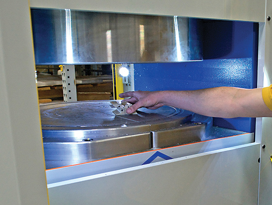

In March 2014, Steelville Manufacturing Co., a contract machine shop specializing in milling, turning, waterjet cutting and metalforming, took delivery of a new sheet hydroforming press (a Triform 24-5BD from Beckwood Press Co.) The bladder forming press features a 24-in.-dia. forming area with a maximum forming pressure of 5000 PSI.
“Before the Triform, we often would form flanges and other part features in a press brake,” says Steelville engineer Joseph Dust. “We would also preform certain parts by forming them into stacked rubber against a male or female die, before finishing them in a secondary operation in a traditional stamping press with male/female tooling. With the sheet hydroforming press, we can bypass those processes and form our parts more quickly and efficiently.”

The last leg of our journey involves sheet hydroforming—forming sheetmetal using a flexible rubber diaphragm or bladder against a single tool or form block. Hydraulic fluid pumped into the bladder pressurizes it to supply a significant and evenly applied force on the entire part surface. Because the bladder acts as a universal die half that conforms to any shape within the forming chamber, only a single tool half is required—traditional matched die sets are eliminated.
