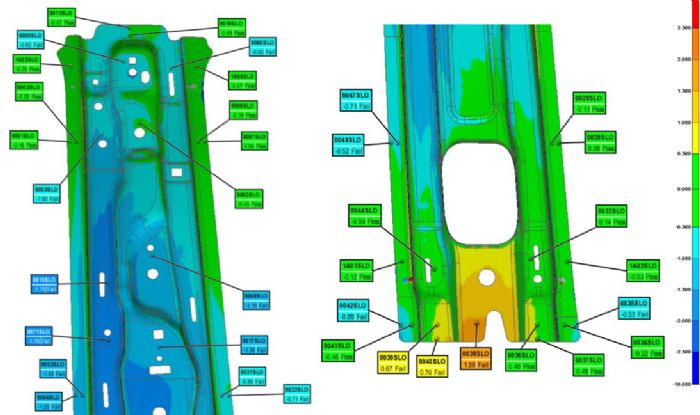

Recently, the company took on a project to design and manufacture progressive dies for automotive center-pillar inner panels, which connect lower frame rails to side roof rails between a vehicle’s front and rear doors. Two parts were needed (Fig. 1), one each for a vehicle’s right-hand and left-hand sides, stamped from 1.2-mm-thick dual-phase material, a low-carbon-equivalent advanced high-strength steel.
Autoform-RIchard-Tool-Die-Center-PillarsEach part required a die to produce, for the life of the program, at a rate of 40 parts/min. while achieving a part-quality level within the customer-specified overall-shape tolerance of +/- 0.7 mm. Areas mating to other parts required a higher shape tolerance:  +/- 0.5 mm. The primary challenge: producing to exacting specifications while dealing with springback concerns, as the material’s tensile strength could reach 1100 Mpa.
Using the AutoForm-Compensator software module from AutoForm, the Richard Tool & Die team was able to accurately predict and manufacture the die face required to overcome extreme springback. AutoForm-Compensator allows users to automatically modify tooling surfaces based on precise springback calculations or measured springback data. With this software, users easily can define compensation regions, which are automatically adjusted using springback results, according to AutoForm officials. The compensated geometry then can be used for rapid and accurate tooling validation.
Autoform-Richard-Tool-Die-ReviewHistorically without AutoForm, the center-pillar inner panels undergo many quality loops in order to achieve customer requirements. In some cases, report Richard Tool & Die officials, achieving a passing panel required more than 10 quality loops—a costly and time-consuming process. Using AutoForm-Compensator produced a passing panel with only one quality loop (Fig. 2).
The AutoForm-Compensator module helped Richard Tool & Die achieve the goal of fully compensating programming sheets with confidence, prior to cutting details, report company officials, noting that this approach proves cost-effective as compared to morphing the panels after cutting details to assess panel quality. Richard Tool & Die now uses AutoForm-Compensator on all of its parts due to its accuracy and consistency.
