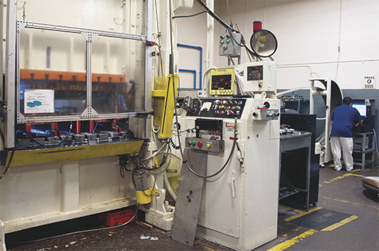

E&E experienced immediate and significant improvement in lot traceability and inventory tracking and accuracy by upgrading its ERP system, as witnessed at this cage-nut press line tasked with fastener stamping and assembly. The operator has a lot to do here, including managing the packaging operation and ensuring quantities are correct. Using the Plex terminal (far left) to log production data, he reports when each box has been packed. Once he has a full pallet, the system creates a master pallet label. The serial number from every box on the pallet then becomes associated with the master pallet’s serial number.

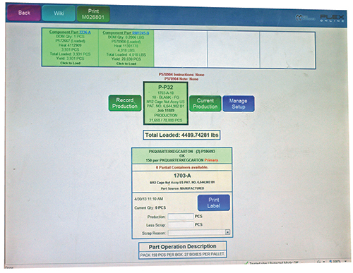

This Plex production-reporting screen lets the operator see how many parts have been placed in a container, how many parts can be stamped from the remaining coil of material and the number of fasteners remaining in the bowl feeders. He also can use data from the system to look ahead and prepare for when the coil will run out, and the location within the plant of additional coils.
