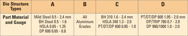

After years of development and plant feedback, the Chrysler Die Engineering Standards Department has developed four types of die structures (Fig. 3) to guide engineers during die design, depending on part specifications. Part geometry, tooling force and material strength were the primary factors used for developing each specific type of structure, considering part material type.
Each of these die structures uses specific die materials and design-structure standards. The build cost and program die time to market are balanced with production-durability needs—Type A standard being the lowest cost and Type D being the most robust, costly and time intensive for die construction. For high-volume (+400,000/yr.) production, die designs are assessed case by case for potential upgrade if deemed necessary during early program reviews.
Fig. 3—The Chrysler Die Engineering Standards Department has developed four types of die structures to guide engineers during die design, depending on part specifications, tooling force and material strength. Type A dies are the lowest cost, Type D the most robust, costly and time intensive for die construction. |
Type C and D die structures are the primary standards used at Chrysler for designing dies for AHSS, which are subjected to higher forces per unit area than are dies developed for traditional steel parts. Compared to more traditional dies, Type D structures feature:

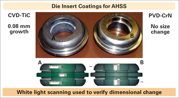

Fig. 4—Chemical vapor deposition (CVD) and PVD coatings have been studied, and as depicted, PVD experiences no size change—the key reason for its use. |
D2 steel was chosen for AHSS Type D structure parts for all working surfaces, after considerable trials with some of the latest comparable grades. We found that conventional D2 performs well when following the proper metallurgical quality and strict heattreatment processes. This was proven to be true when nitriding (without white layer) plus application of a physical vapor deposition (PVD) coating. In addition, D2 offers the lowest overall cost and is most readily available globally.
Chemical vapor deposition (CVD) and PVD coatings have been studied, as applied research projects and in production trials. We have compared distortion experienced by tools undergoing each process (Fig. 4). As depicted, PVD experiences no size change, the key reason for its use.
