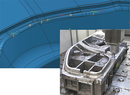

Creating fillet radii is another area where the software shines. In one case, an Autodie engineer had to redraw a wall nearly two-thirds of the way around an automotive door ring, which had been imported from a compensated and optical-scanned surface. In straight CAD software, this can be an all-day job as it can be performed only in small sections at a time, with considerable manual effort. With ProcessDesigner, the addenda draw wall was redrawn and a variable fillet radius created, from the bottom of the ring to the top, in only 15 min.
