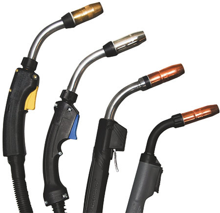

Reduce Strain with the Right Neck
Many GMAW and flux-cored guns come with rotatable and flexible necks in various lengths and angles. These neck types allow the welder to select the one best-suited to access the weld joints required for an application.
For example, rotatable necks find use when welding out of position, even overhead. They do not require the welder to change the welding-gun handle or position, so he can hold the gun in a that is most comfortable while also gaining access to the weld joint.
Similarly, flexible necks can easily be adjusted to fit different welding angles and reach difficult joints that may be restricted or otherwise awkward to reach. This feature also helps minimize straining to reach a particular weld joint, reducing the opportunity for fatigue or injury.
Some welding-gun manufacturers also offer neck couplers. These accessories allow the welder to connect multiple necks together to comfortably reach weld joints that are particularly difficult to access.
