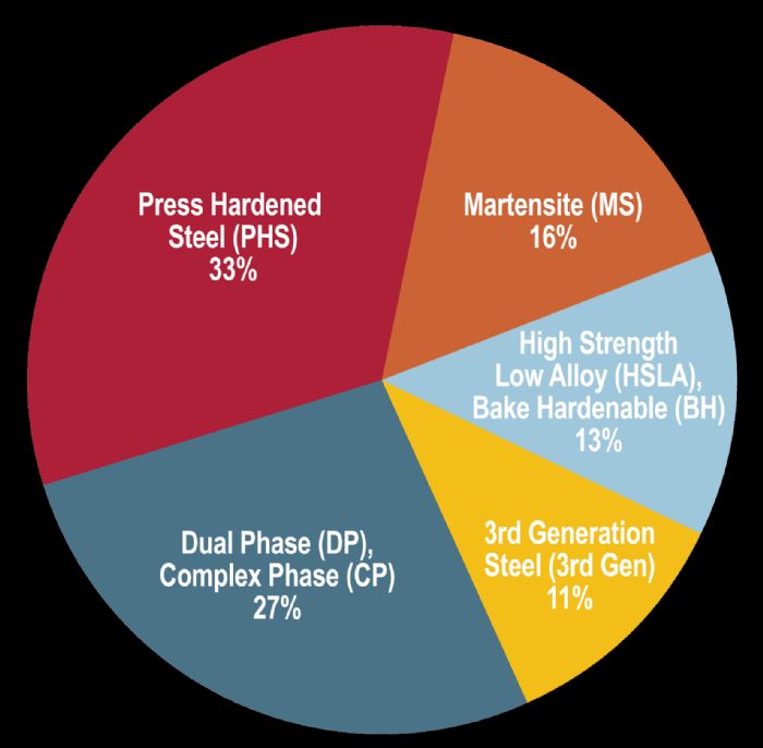

  • Average tensile strength for the body structure: 1259 MPa

worldautosteel-steel-emotive-body-structure-AHSSUsing the newest steel grades and fabrication processes, Steel E-Motive’s portfolio enables tailoring vehicle properties that achieve significant safety, cost and comfort advantages with seven key innovations only possible using steel:
worldautosteel-steel-emotive-material-mix1.       B-pillarless, one-box open body structure
