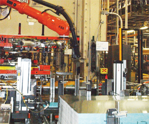

The entry end of press-line B where a Rexroth-driven air-knife system separates blanks and an overhead-mounted camera system checks blank position (as needed) before blanks feed into the first press, for drawing dishwasher-tub bottoms. |

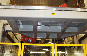

Overhead shelf-mounted robots along B line transfer tub-bottom stampings to keep the front area of the press clear to accommodate die changes.

The plant’s robotic supplier of choice: ABB Inc.’s press-automation systems group, in Brampton, Ontario, Canada. ABB also integrated new blank-destacking technology and developed custom vacuum-cup-style end-of-arm tooling to handle the various blanks, including the double-wide blank used to stamp the tops two-out. Several of the press-to-press transfer robots on A and B lines (model IRB 6650S robots, 3.5-m reach, 125-kg payload capacity) mount overhead on shelves, keeping the front of each press clear to facilitate die-cart access for simplified die changes. Destacking and unloading robots, as well as inter-press robots on D line, are floor-mounted IRB 6640 models—3.2-m reach, 130-kg load capacity. Accompanying the move to robotics was an upgrade of all press controls to new OmniLink 5000 press and automation controls, with Omni-link II operator terminals, from Link Systems.

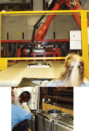

End of line B, where an operator stacks completed tub bottoms and sends them on their to the clinch-seaming machine for assembly to the tub wrapper. Seaming requires a very thin and tightly toleranced flange around the perimeter of the part —the accuracy and repeatability of the press-loading robots ensures the precision of this flange dimension to avoid a problem at the seaming line, where one misstep means scrapping out an entire tub. |

Blank adhesion from curing dry lube once caused headaches for the plant’s press-line operators, until ABB’s press-automation team took on the new automation project for Hipsher and his group. To ease robotic destacking at the front of the press lines, ABBdesigned and integrated air-knife fanning systems driven by a Bosch Rexroth/Indramat servo drive.

At the beginning of each destack cycle, an eddy-current sensor checks for double blanks; a positive result sends the robot back to the stack to release its load and try again. It makes three attempts to pick one blank before calling for operator intervention. Also, at the beginning and end of each stack, an ABB-engineered vision system kicks in to inspect blank position in space. An overhead camera snaps a photograph of the blank as it’s held by the robot end-of-arm vacuum-cup gripping tool and compares its position to the programmed position.
