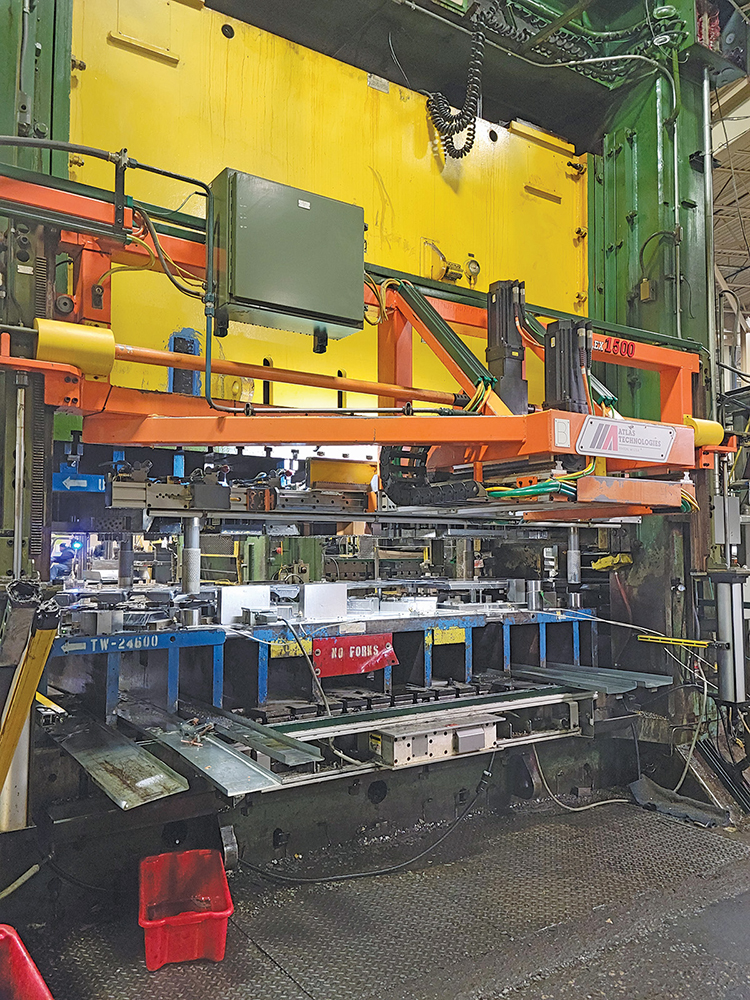

A key to meeting production and profit targets on volumes large and small involves transfer system performance, according to Siess. BAE houses two Atlas Technologies front-and-back three-axis electronic transfer systems. One, a Flex 1500 model on a 1200-ton 144-in.-bed press at the Warren plant, was installed in 2015; another works on a 2500-ton 240-in.-bed behemoth in Fraser, refurbished and added to production in 2017.
The high-speed programmable Flex 1500 can integrate with a new press or be retrofitted, and can transfer as much as 450 lb. of parts and tooling, offer Atlas Technologies officials, at stroke rates to 36 in. An overhead-mount design eases access to dies, with the bolster left open for scrap removal, and press windows clear for part-feeding equipment. And, jogging—forward and reverse, using a virtual press-simulation feature—acts independently of press actuation, allowing for cycling without the risk of die interference.

“Front-and-back transfers have tremendous flexibility and structural advantages over other types of transfers,” says Siess, “starting with the ability to switch from progressive-die to transfer-die mode and back in 3 min. or less. And, moments of inertia and bending moments in a front-and-back system allow for higher speeds, and the system offers a far more mass-efficient structure. Everything about it is a win. The drives are smaller, but the transfers run faster, with less bounce.”
3-Automation-Atlas-BAE-Universal-ToolingConsider, for example, a transfer system for a 240-in.-bed press.
“The longest transfer component in a 240-in.-bed transfer press at our facility is the universal transfer rail, and in supporting that, no member is longer than 4 ft.,” Siess explains. “In that same press, a through-the-window transfer system has 30-ft.-long beams, with all of the moment-of-inertia and bending-moment issues, as well as the large drive sizes necessary to handle the increased mass, and all of the bounce that transfers to the finger tooling.”

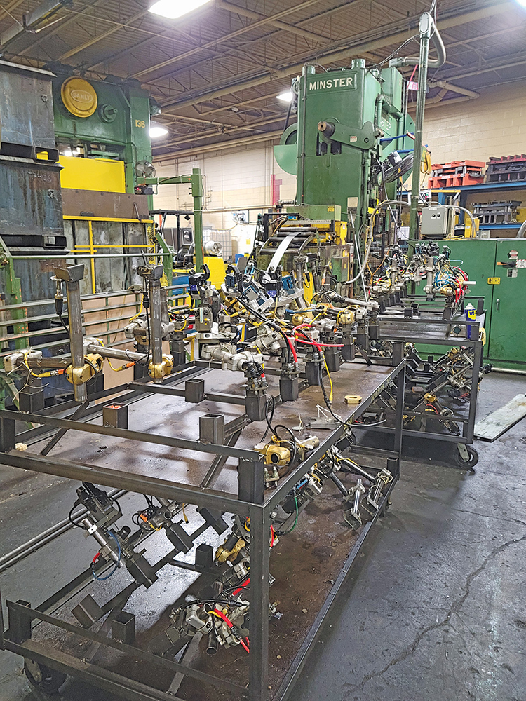

Opt for Universal Tooling
“I am adamantly opposed to dedicated finger tooling,” Siess says, citing costs that can run to three times that of universal tooling, as well as flexibility. “All of our universal rail tooling has been through three, four or five reapplications, retrofitted for each new job as needed. When we finish using it on one job, we place it into a cabinet, then take it out and adapt it for another set of tooling. The universal tooling rails provided by Atlas Engineering really allows us to be flexible, and it provides a real advantage. Dedicated tooling just becomes obsolete when a job ends. I would push universal rails for anyone in contract stamping.”
BAE Industries maintains finger tooling at the ready for quick connection to rails as needed, making job changeover a rapid and efficient process.
“As a contract stamper,” says Siess, “we sell our ability to run a customer’s offload tooling in our presses. Universal rail tooling makes it much easier to do that.”
