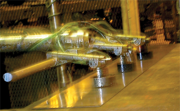

Tower’s press-setup crews can easily customize end effectors with a combination of suction cups and retrofittable low-profile magnets, thanks to its use of these 3-in.-dia. Transporter magnets that thread onto the typical 3/8-in. NPT vacuum-cup tooling. |
“We’ve got hundreds of end effectors here,” says Tower tool and die supervisor Sean Klosowski. “We design the end effector based on the shape of the part, combining pneumatic suction cups with magnets.”
Allowing Tower’s press-setup crews to easily customize end effectors is the firm’s recent switch to retrofittable low-profile magnets (3-in.-dia. Transporter TPLP30’s, from Industrial Magnetics, Boyne City, MI) that thread onto the typical 3⁄8-in. NPT vacuum-cup tooling. “The magnets are nice and small and are perfect for gripping parts with really complex shapes with deep contours,” says Klosowski, “such as shock towers. The magnets don’t require a flat surface to grab onto, and of course holes in the part don’t affect the grip.
“Also, we’ll have situations where the amount of available press stroke can prohibit suction-cup access to parts resting in the die,” Klosowski continues, “and here again is where the low-profile magnets prove perfect. Some of our presses have 24 in. of stroke, and for some parts that’s not enough to get in with a suction cup and lift the part off of the bottom die.”
