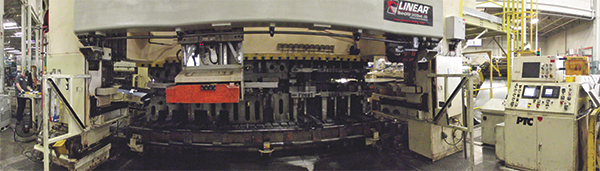

For an up-close perspective on the prog-to-transfer process, Stirrett hooked us up with fellow Canadian company Egar Tool and Die, Cambridge, Ontario, who he says helped to pioneer the concept back in 2010. Egar is part die shop part stamper, with four production presses from 400 to 1200 ton. Its two largest presses—a 1000-metric-ton PTC (84 by 180 in.) and a 1200-ton Blow (80 by 180 in.)—feature three-axis Linear Transfer servo-based automation systems. They also include 72-in. coil-feed lines accepting coils to 50,000 lb.

“Coil-fed transfer allows us to squeeze every bit of material out of the coil as possible,” says Kools. “But the dies are more expensive than traditional dies because once we blank we have to separate and rotate the blanks using mechanical or pneumatic devices. We separate the blanks and move them outward, closer to the transfer rails, so that the transfer arms can be shorter—this makes for a more rigid process so we can run more quickly. We also rotate the parts to position them optimally for engagement by the transfer tooling, and for optimum design of each die station.
“We use a lot of sensors on the dies and the transfer tooling,” Kools adds. “That said, in most cases we can justify the added cost to the dies within a year or two of production due to the material savings.”
