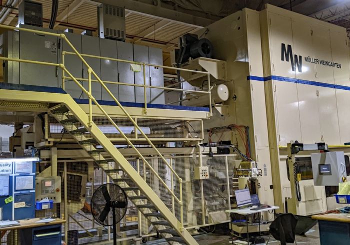

“The ongoing issues with the outdated control on this press were impacting overall equipment effectiveness (OEE),” shares company vice president and sales manager Tuncay Onursal. “Lack of available spare electronic components for the press and control system became a significant issue, and we wanted to provide our operators and maintenance team with an updated press line that would enable them to be as productive as possible.”
The press-refurb project came to a head in November 2020 during a planned six-week window to shut the press down for its makeover. Partnering with Toledo Integrated Systems for the turnkey project, Ernst installed a complete control solution for the MW press, as well as its servo transfer system and zig-zag servo feeder. Toledo Integrated, along with a complete press rewire and new electrical enclosures, replaced the aging press control with an Allen-Bradley GuardLogix Safety PLC, “to run the press, transfer system and feeder,” explains John Eby, sales manager at Toledo Integrated. “We also upgraded two servo axes on the feeder—transverse and longitudinal—and 12 servo axes on the transfer system, including two for gripper-width adjustment, installing Allen-Bradley Kinetix servo drives.”

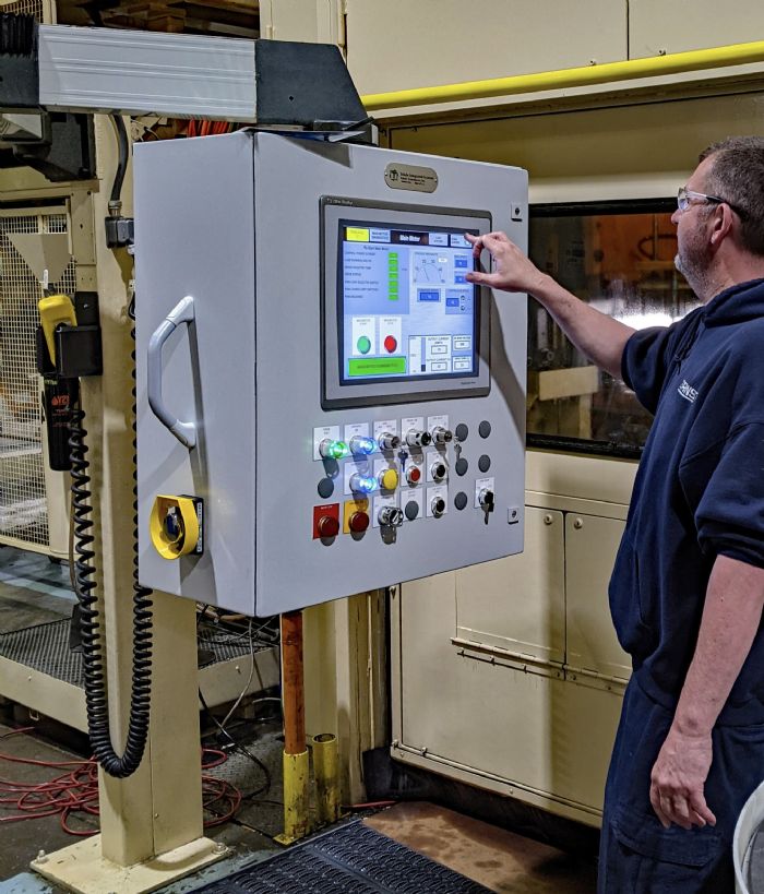

But wait, there’s more…much more. Included with the project is Ethernet communication to the PLC, safety I/O, HMI and drives; updated safety using Allen-Bradley Safety Point I/O modules; new servo motors; a new Allen-Bradley 275-hp main motor drive; Toledo Integrated’s PressWatch signature-based tonnage monitor, with 1-deg. resolution; “and, last but not least,” says Eby, “tying it all together for the operators and maintenance team at Ernst is a 19-in. Allen-Bradley PanelView control screen.
“While we don’t see many shops go with the large screen,” Eby continues, “the advantage can be tremendous. It gives the press operators and the maintenance team immediate access, on just a few screens, to all of the information they need for setup as well as for production and troubleshooting.”
What Makes a Good HMI?
Photo B Ernst operatorWhen one vendor, in this case Toledo Integrated, manages an entire line upgrade such as this, it’s easier to ensure that the customer and its various work teams—production, maintenance, quality, etc.—get exactly what they’re looking for. In Ernst’s case, the custom HMI is exactly what the (press) doctor ordered. Some of those key HMI characteristics:
  • Self-explanatory, intuitive and easily understood
  • Information conveyed on the home screen based on input from the operators and their individual needs
  • The large display, so as not to cram too much information onto one screen
  • HMI graphics that illustrate the production process, to provide better visualization to the operators and maintenance technicians, giving them a sense of the action that’s required.
“The home screen includes all of the information the operator needs to know to ensure that the process continues to run per spec,” explains Ernst maintenance manager Jacob Crabtree. “That includes press tonnage, feed and press speed, and data on the hydraulic systems. And, prior to the upgrade the press lubrication system had its own independent control station. Now, that functionality is included in the new HMI and at the operator’s fingertips.
“From a maintenance perspective,” Crabtree continues, “with the original press control troubleshooting, an error message was often complicated and time-consuming. Identifying and locating faults could take hours. This new control pinpoints faults immediately and provides all of the information needed to quickly address them. We also can connect a PC to the control to look at the PLC files, greatly streamlining some troubleshooting efforts.”
