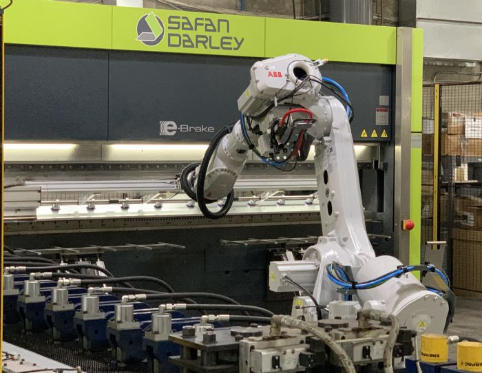

“After thoroughly reviewing the press brake operations at Metal-Era, we proposed some renovations to the existing cells, much of which we also incorporated in the design of the new cell,” says Andrew Fischler, IAS project engineer. “A big part of it: replacing older robot models with the new-generation ABB IRB 6700. We also designed an innovative vacuum-suction end-of-arm-tool (EOAT).”
The IRB 6700, part of the seventh generation of ABB large robots, offers enhanced speed, payload and accuracy, according to ABB officials. Other reported advancements: power consumption decreased by 15 percent, total cost of ownership reduced by as much as 20 percent, and optimized maintenance, which doubles the time between service intervals as compared to similarly categorized robot models.

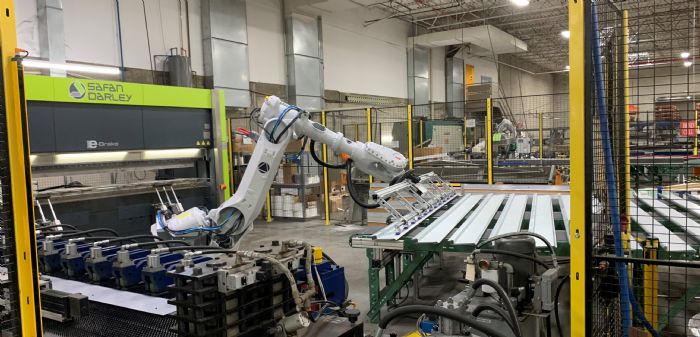

Each IRB 6700 model installed in the Metal-Era cells features a 155-kg payload—more than enough strength to handle the intricate EOAT and steadily place a 12-ft. fascia part into the press brake. And, a 2.85-m reach allows access to all points of the cell where a robot picks and places each part, before, during and after the press brake’s bending operation.
The IAS-designed EOAT features 12 vacuum suction cups mounted on two shafts coupled together to form a channel for the vacuum conduit. The entire EOAT shaft can rotate to pick and place the metal fascia sheets without the robot colliding with the press brake. The EOAT maintains a secure grip on the part while in the brake, precisely repositioning the part through the various intricate bends of each cycle.
Programming Optimizes Cell Throughput
The bending cells include all of the equipment and processes needed to transform stacks of raw sheet metal stock into finished lengths of roof fascia. Processing starts with 4 by 12-ft. sheets sheared into widths to 16 in., and continues through an operation to punch holes for installation mounting, to an operation to notch corners for product variations that may need to be folded, and then to a machine that stamps one of the many possible product logos. IAS specified the equipment and designed the gantry systems that move the blanks between each punch, notch and logo (PNL) station.
Once through the PNL process, the robot picks up the part and loads it into the press brake. After positioning and repositioning the part in the press brake for a sequential series of as many as five bends, the robot places the part on an outfeed conveyor for packaging and shipping.
