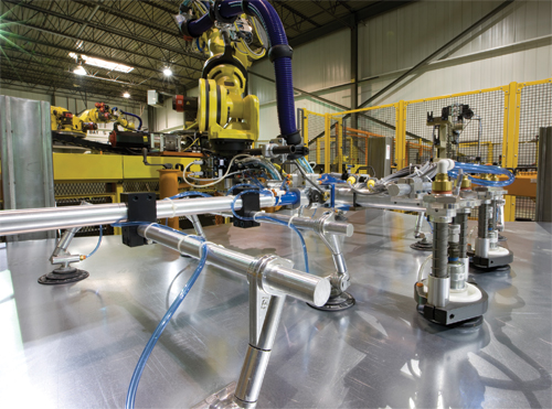

Between the pallet stations and within the safety gates, a dual-station tooling nest serves the destacking robot, with another tooling station positioned adjacent to the press-loading robot. Both stations can store vacuum-cup tooling while the robots operate with other tools. When a part recipe indicates the need for a tooling change, the robots automatically deposit one tool and retrieve the staged tool from the station.
With blanks queued in both pallet stations, the first robot grabs a single or double set of blanks with suction cups and places it in the centering station. The gravity-fed table allows the blanks to quickly glide into orientation for the second robot, which picks up the centered blank and feeds it to the press.
Because the destacking system employs two load stations, an operator can change tooling and prepare the stack in one station as the second station feeds material into the press. Thus, the system can operate in continuous mode when both stations are loaded with the same type of blank. Alternatively, the stations can be readied for quick die change with a new set of blanks in the station, ready for when the current station is depleted of its production run. The system can be configured to handle just about any shape of blank including irregular and tailored laser-welded blanks, according to TKSE officials.
