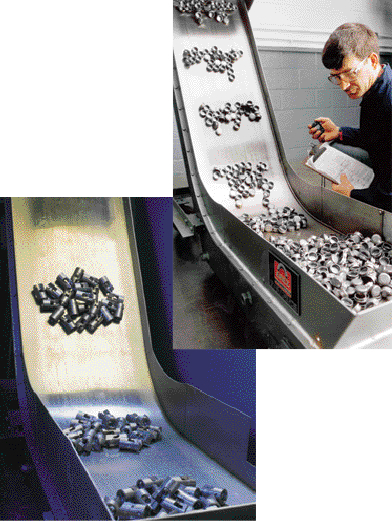

Magnetic conveyors offer an efficient and dependable method for handling ferrous materials. These units convey chips, nails, stampings, cans, small machined parts and related ferrous scrap efficiently and economically using magnetic power.
Permanent-magnetic chip and part conveyors handle many sizes of ferrous materials, including small parts, stampings, scraps or chips. Permanent magnets move inside of a liquid-tight submersible housing and attract, hold and convey the materials. A lack of any moving external parts prevents jams and helps minimize risk of operator injury. And, the material being handled slides along a stainless-steel slider bed, so, as with a vibratory conveyor, there is no belt to damage or jam.
Metalformers can develop a variety of magnetic-conveyor configurations, in many sizes and widths, to be assembled from standard sections. This allows simple and economical installation of units to service hard-to-reach areas under presses, mills, cutoff saws or other machines. Standard conveyors are available as straight horizontal units or with an angled incline as great as 90 deg. Models also are available with large, sweeping radii to elevate long, difficult-to-handle scrap or parts.
Advances in materials and the use of UHMW (ultra-high molecular weight) polyethylene track by some conveyor manufacturers have essentially eliminated maintenance issues related to conveyor tracks. With no external moving parts, magnetic chip and part conveyors typically require the least amount of maintenance of all conveyor types. Belt wear typically is less with magnetic conveyors than nonmagnetic, because parts remain stationary on the magnetic belt and have little chance of working their underneath the belt to cause wear.
