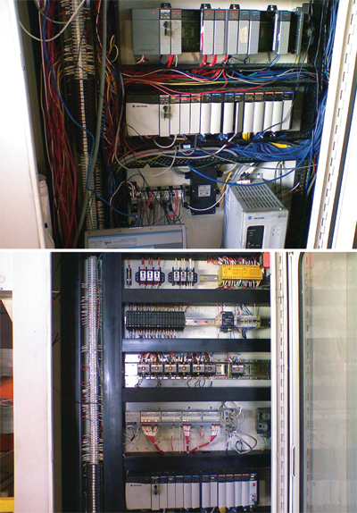

A Controls cleanup can address pressline problems
A controls cleanup can address press-line problems caused by the addition of equipment to the line over time without planning for consistent and adequate control of that equipment. A cleanup can ease troubleshooting (with a fault log and fault descriptions easily available via the control panel or remotely), leading to increased uptime, and ease line expansion the next time around.
One recent Toledo Integrated Systems project addressed line integration and control cleanup at an automotive Tier One stamper in Ohio, which over the years added a decoiling unit and feeder to a mechanical press.
“The line employed two controls that each required different software to program,” says Eby. “They could communicate with each other but not very smoothly. The customer asked us to place the controls on the same platform. In addition, equipment drives had faulted intermittently, which inhibited production. All of this affected the ability to troubleshoot.”

Specifically on the Tier One project in Ohio, the existing uncoiler drive was faulting out multiple times per day.
“Because control-communication problems hampered troubleshooting, the stamper did not know why the faults occurred, but would just reset and the line might run for another hour and then fault again and shut down,” says Shane Steinhardt, applications engineer.
In addition, the line’s looping pit would periodically encounter a tight-loop condition, also affecting productivity. And, adding on to the older control system over the years with equipment from various vendors further strained line operation and troubleshooting.
The cleanup included replacement of three human-machine interfaces with two units to simplify line oversight and incorporation of open-architecture communication to ease connectivity between line components and the overall control system. In addition, the stamper chose to replace existing older-technology DC drives and motors with new AC units. The installation of a shared DC bus between the uncoiler and the straightener axis helped share regenerative energy produced by the uncoiler during normal operation. The net result: less downtime leading to improved productivity, which illustrates the power of improved controls for cobbled-together press lines.
