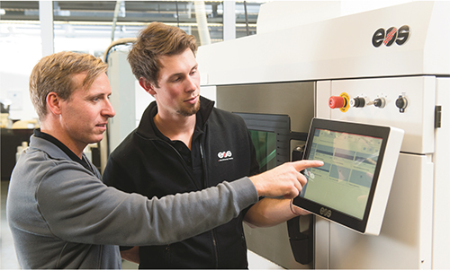

For example, with the aim of minimizing machine downtime, AM-machine controls now can send SMS text messages to operators. Such a message might, for example, alert the operator that a build is nearly complete, and that he should prepare to open the process chamber, remove the part and prepare the machine for the next build. The goal is to minimize changeover time.
