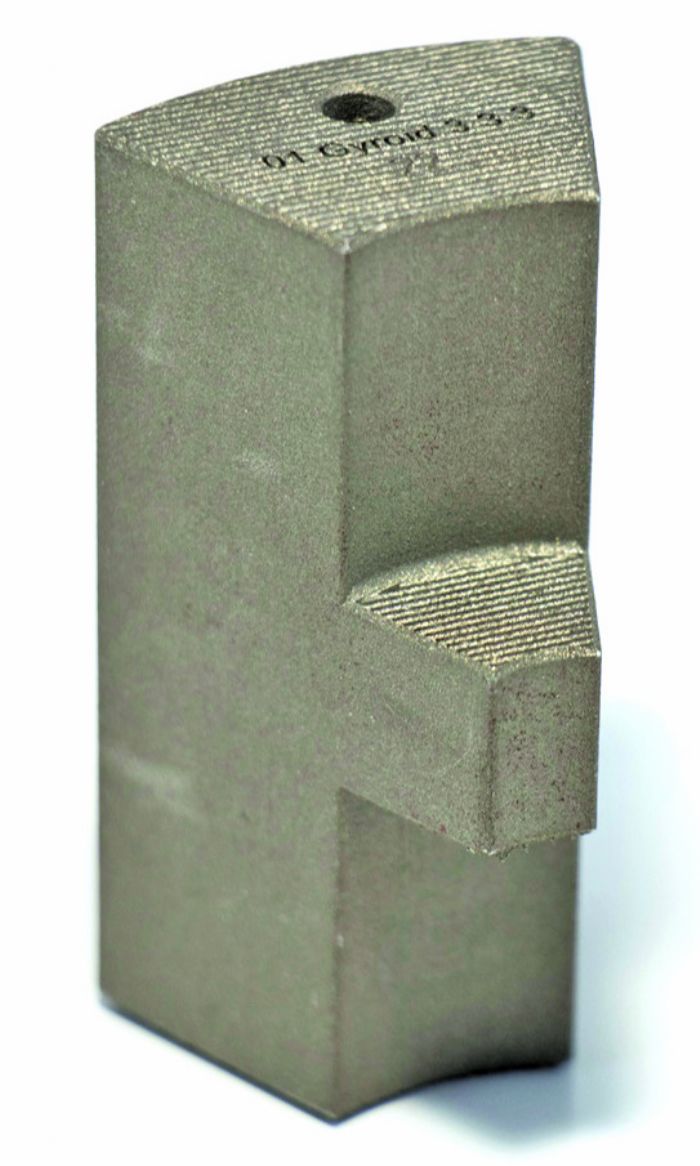

2-BEFORE-Post-Processing-Lillbacka-PostProcessFinding traditional blasting procedures to be too time consuming, Finland-based Lillbacka Powerco Oy, a manufacturer of crimping technology, in 2020 selected a Rador automated surface-finishing machine from PostProcess Technologies to match post-processing of parts to the efficiencies of its AM production.
Lillbacka employs direct metal laser sintering (DMLS) to produce end-use crimping dies used in the machines it builds. Though AM productivity benefits had proved evident, post-printing procedures proved time-consuming and labor-intensive. The highly manual process consisted of multiple steps. Once depowdered, parts required treatment with a manually operated glass-ball bead blaster, then deburring to smooth out roughness. While hindering workflow, these processes also presented part-quality and -consistency challenges. Lillbacka struggled with varying surface finishing/roughness results as well as breakage.

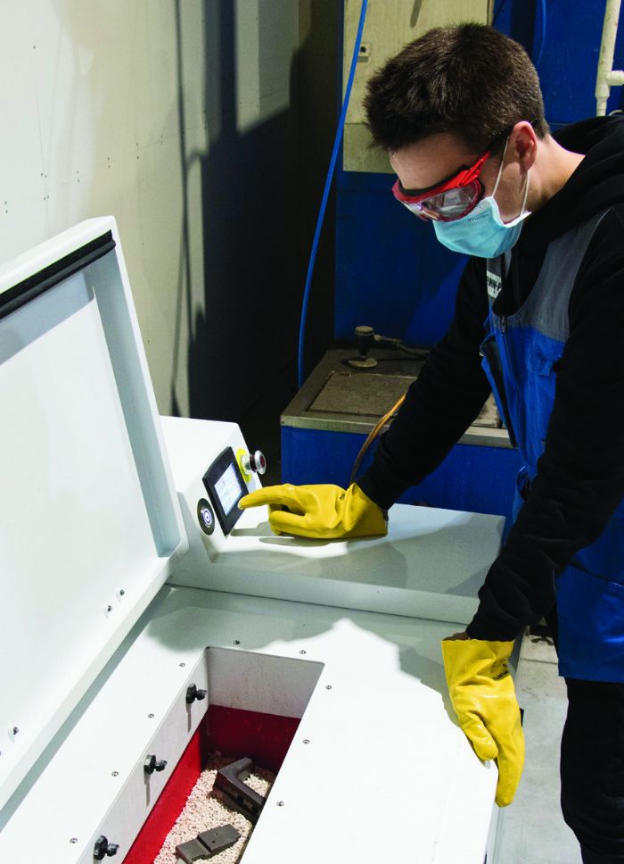

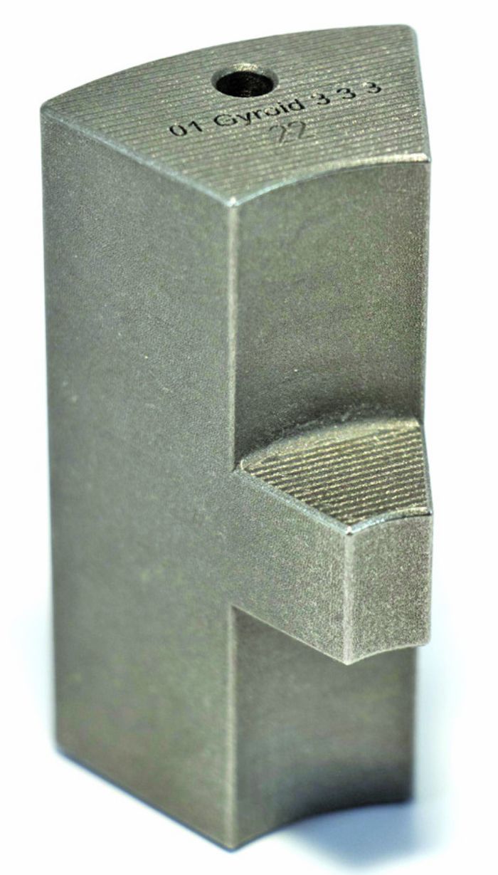

3-AFTER-Post-Processing-Lillbacka-PostProcessTo overcome these challenges and better serve custom-tooling requests, Lillbacka employed Rador, which uses PostProcess’ Suspended Rotational Force (SRF) technology, to finish the company’s DMLS parts consistently to specifications. The Rador machine uses SRF—software-driven agitation settings to suspend parts within an abrasive mix of media and detergent—to achieve desired surface-finish and dimen¬sional consistency.
Lillbacka, through rigorous testing to determine the efficacy of various finishing processes, found that the Rador predictably and repeatedly achieved final Ra values of 1.6 µm on a part with an original Ra of 6.5 µm. Conversely, manual bead-blasting results tested as highly unpredictable, achieving final Ra values between 4 and 5 µm. In fact, of five surface-finishing methods evaluated by Lillbacka, according to company officials, only the automated finishing method provided the ability to scale throughput with impressive surface-finishing consistency.
